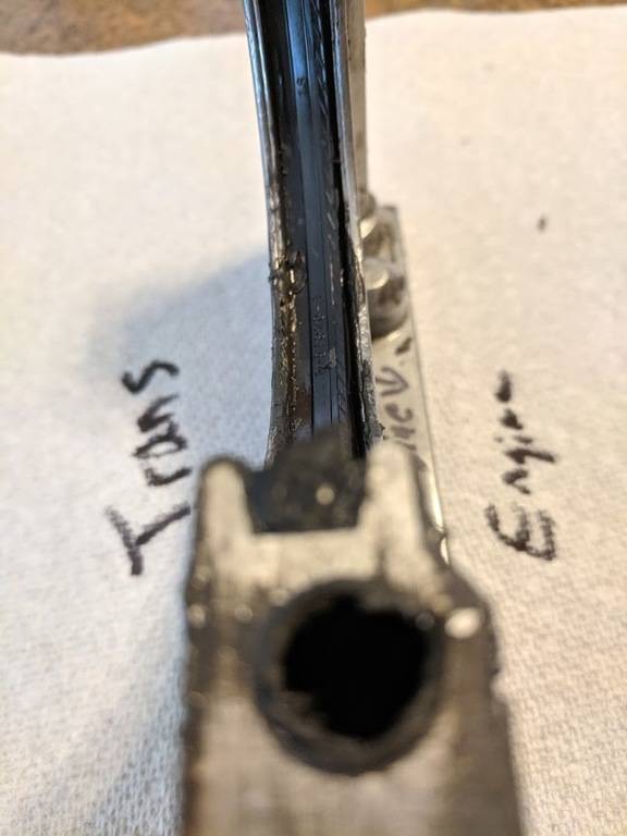

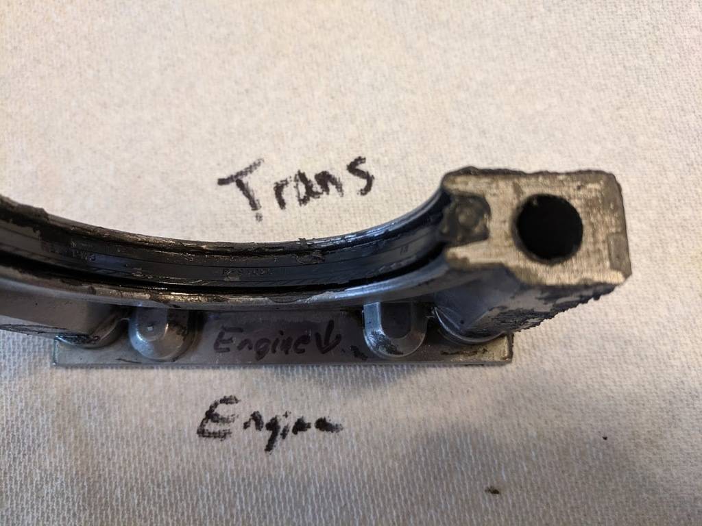

    Leaking again, took it apart today and now looking at it, I think I installed it backwards. Take a look at the pics and let me know please. Going to remove and clean everything and install new one but want to make sure the new one is in the right direction. Thank yous in advance!

    Years ago, there was a letter to the "fixer column" n Popular Science magazine, or possibly Popular Mechanics, where the guy had replaced a seeping rear main seal, only to have the new one leak at least as bad. What went wrong, he wondered?
    The reply mentioned a knurl pattern on the middle area of the seal face. They are designed to "pump" any oil that gets past the inner lip seal back toward the crankshaft. If put in backward, it "pumps" it to the outside. First time I'd ever heard of that! Not sure if that might be operable in your case or not, but wanted to mention it.
    Otherwise, some seals re-locate the main lip seal contact area to not be where the prior seal touched the spinning shaft. "New territory" to seal against, even if it's .020" different. So looking for a slight groove in the rear main seal surface on the crank might be operative? Perhaps some replacement seals are a slight bit undersized (thicker seal) in that area, for that reason?
    Hope you get it all figured out!

    Like said before...
    1. Stagger the gaps tween the seal and the cap.
    2. Don’t be stingy with the RTV.

    Yes from what I can see it looks correct.

    I'm just going to toss this out there... Are you 100% sure it's the seal?
    I've seen where a leaky oil sender drips enough oil around the bellhousing to mimic a bad rear seal.
    • Agree Agree x 3

    Yes, first thing I checked.
