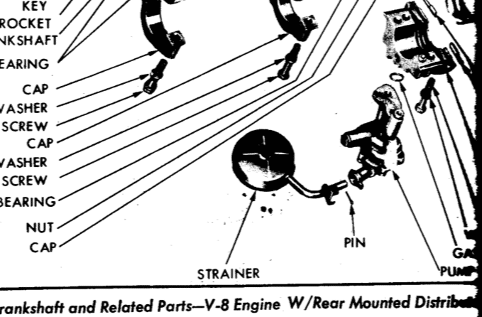

trying to move forward here got seal in place now putting oil pump in does the oil pump need a gasket between the pump and the bearing cap i have heard a thin gasket i have heard of a o ring and people running nothing its a 318 65 plymouth fury poly motor stock book states put back together tighten it down im stumped
Most of the stock 318 poly engines used an o-ring between the pump and the mount point. Look at your pump, it should have a small recess to hold the o-ring. Photo is attached, click on Mail0141.PDF, not the icon.

i see it took a quick pic of it

my god thank you
