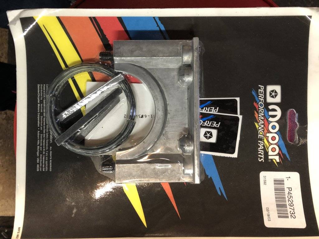

Thanks for the info, my rear main seal has been leaking For a couple years now and it’s gotten very bad. I had it up on my car hoist to verify the leak. I bought the seal a while back thinking it’s a winter job. It won’t wait. Hers a pic of the new seal I’m going to use.
Boy that's old stock, 02/19/03 date.
Yea those are the newer 2 piece rubber/silicone types, you may still have a rope seal, if you do have a old harden rope one there are some tricks to get it out. Just read the install directions on the new one carefully and don't be shy with the grease in the curve of the seal, just avoid the ends as you want the RTV to make a good seal. I've had that type go in easy but some I've had to loosen all the main cap bolts to let the crank drop just a bit to get it to slide in (truck application). The ***** of the job is dropping the Y-Pipe if you have a single exhaust and your flange nuts and bolts are rusted tight. Burn Baby Burn, just torch them off and put new ones in.
Let us know what was in there that you remove, the way I remember the rope seals went, white asbestos? rope OEM (soak in engine oil for 24hr before install) to black graphite rope, and now the 2 piece rubber/neoprene/silicone type.

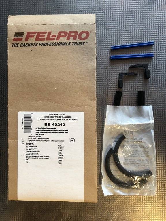

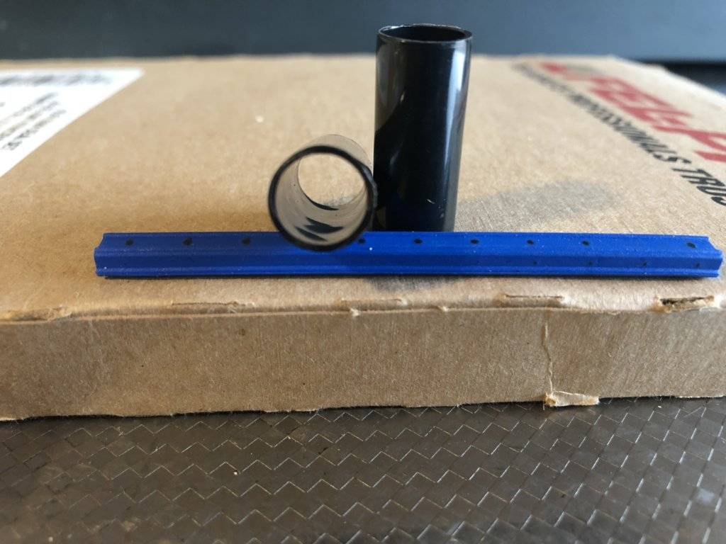

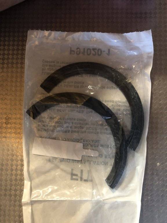

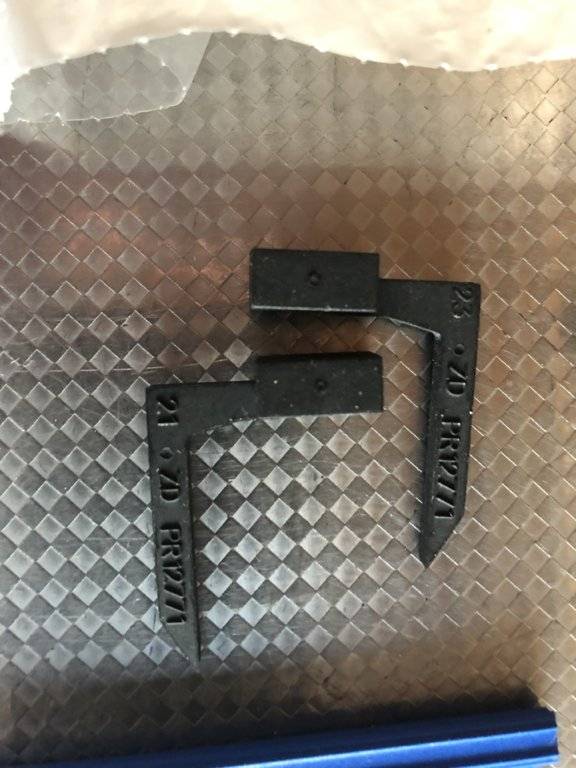

My seal has been replaced at least twice In its life the last time was in 1998 when it was rebuilt. A few years back i bought the Fel-Pro rear seal kit and noticed it had a few extra parts in the package. Then thinking I may need other seals and gaskets down the road I bought the whole kit at a swap meet. Ya I know - my name is welder guy and I have a buying problem. Here’s a few pics. I’m not sure what the Small black tubes or the L shaped parts are for , they are not included with the mopar seal. Thanks again for the information!

Those extra's are FelPro's way/idea? to make sure it's a leak free endeavor.
Again read the instructions and look at pictures/diagrams (if any).
