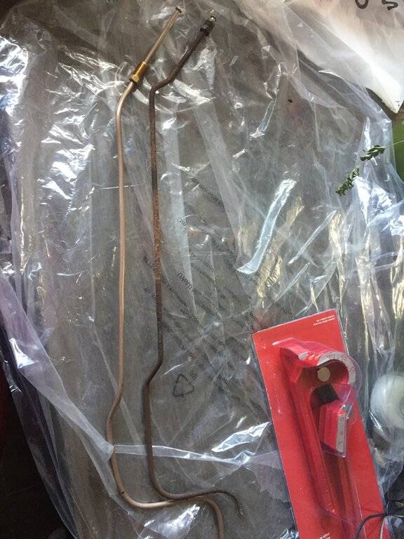

Took the old one off and I was worried about how frozen it would be at the T junction. Picturing that breaking too ...
Put the wrench on and it just turned ever so easy. Why couldn't the nut at the wheel have done the same thing?! (Yeah, I know, it's all the crud, corruption and communism that splashes up against the wheel and not above the differential.)
My wife was outside in the driveway when I took it off and so I showed the line to her. "Is that all?! You'd better be able to do that yourself."
Ghostultramarine
May 9, 2021
274
76
Saskatoon, SK
Grabbed some of the copper nickel line. That stuff is very soft - so easier to work with.
Had some trouble lining up the line to the T junction block on the differential (probably from lying on my back and connecting the wheel first).

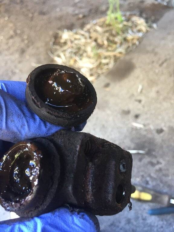

Changed out the wheel cylinder. Looks like it was time...
Gerald Morris
Mar 9, 2016
2,137
1,058
Tucson
Yeah. The soft lines get brittle over time, and will eventually break, but for now its good. I'd say your brake cylinders should've been changed about 30 yrs ago. I'll have to work over all the brakes on Gertrude soon. I don't trust the Yahoo who flipped her to me. He used NAPA bearings. Not good enough, though not the absolute worst either.
