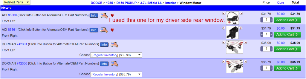

I used the window motor from a 1985 Dodge truck for one of my rear regulators on my 70 SF. It is plastic but it bolts in and is much faster than the original motors.
