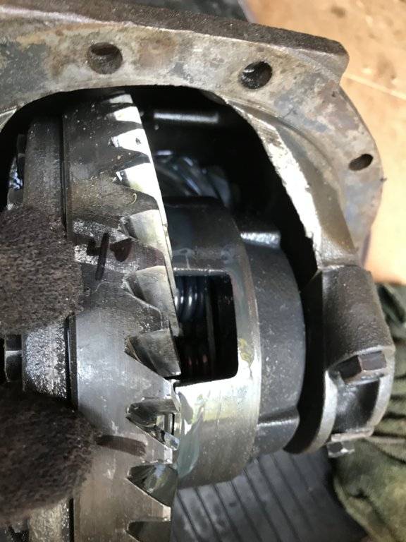

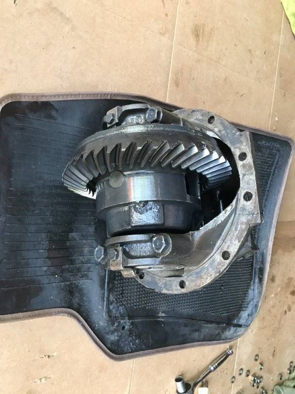

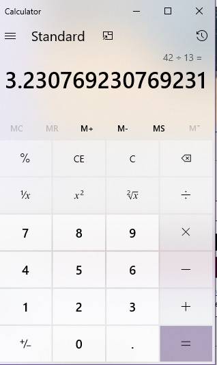

Ok I pulled the center section out of FURYIOUS today. I told you guys I counted & divided the teeth to come to a 3.08 ratio. Everyone said no such thing in a 8 3/4. Ok I count 42 ring gear teeth & 13 pinion teeth & my math skills shows that to be a 3.09
