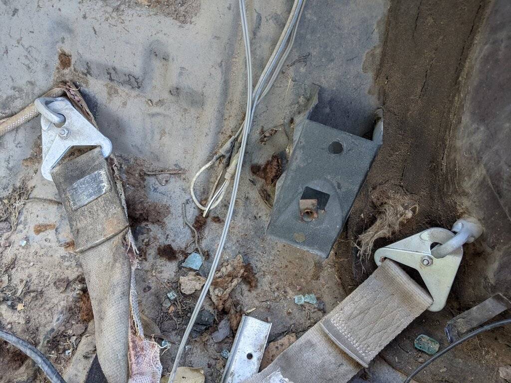

My '65 Barracuda, that has the optional rear belts. These are the original belts.

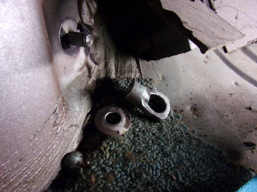

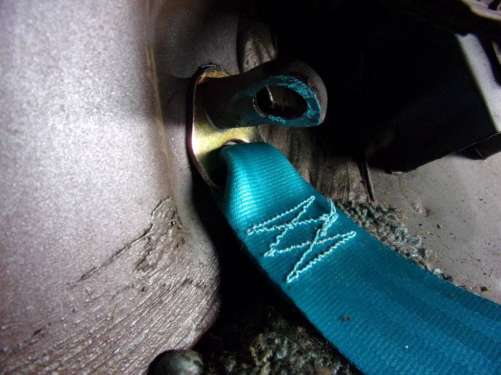

Thanks everyone for your responses. The seat belts I bought online weren't set up with the buckle like the one shown by Big John. So, I unscrewed the loop and discovered it was basically just a fine-threaded nut. I simply used it as a nut. Cue the naysayers.
Whatever works . . . might want to put a large diameter flat washer under it, though.
Yes, the factory already had a 2" washer on the backside, I just re-used it.
