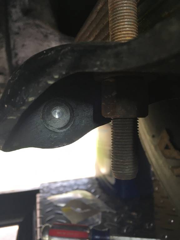

One of those people changed the leaf springs on my car when the previous owner had it. Along with screwing up the shackles and leaving the old, rotted, rubber bushings in place, they also cross threaded and stripped the threads on the left lower shock mount.
When I replaced the springs, I didn't realize the damage until I got it back together. I used a longer nut (one of the old u-bolt nuts) and that helped, but it wasn't really secure. It held together though... keeping the shock on, but I couldn't really tighten the nut.

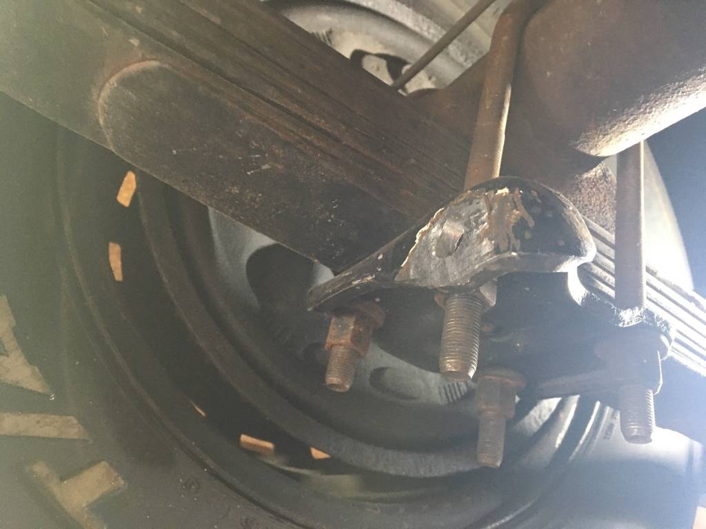

So... I looked around for a lower spring bracket. Come to find out, the bracket is the same as the B and E bodies, so I guess that makes them made out of gold... Anytime I found one for a decent price, it was the right side and, of course, I needed the left.
Kept putting it off... Said I was going to fix it "this winter" a couple times.
So... I did a little research and come to find out, Dorman makes a replacement shock mount and it's $6. This appealed to my cheap C body nature, so I ordered one.
https://smile.amazon.com/Dorman-HEL...1&keywords=dorman+31001&qid=1587327543&sr=8-1
The diameter where the shock slides on is just a RCH smaller, but we're talking a rubber shock mount that will easily squeeze down on it. Thread diameter is smaller too, but that won't affect anything. Everything else looks good.

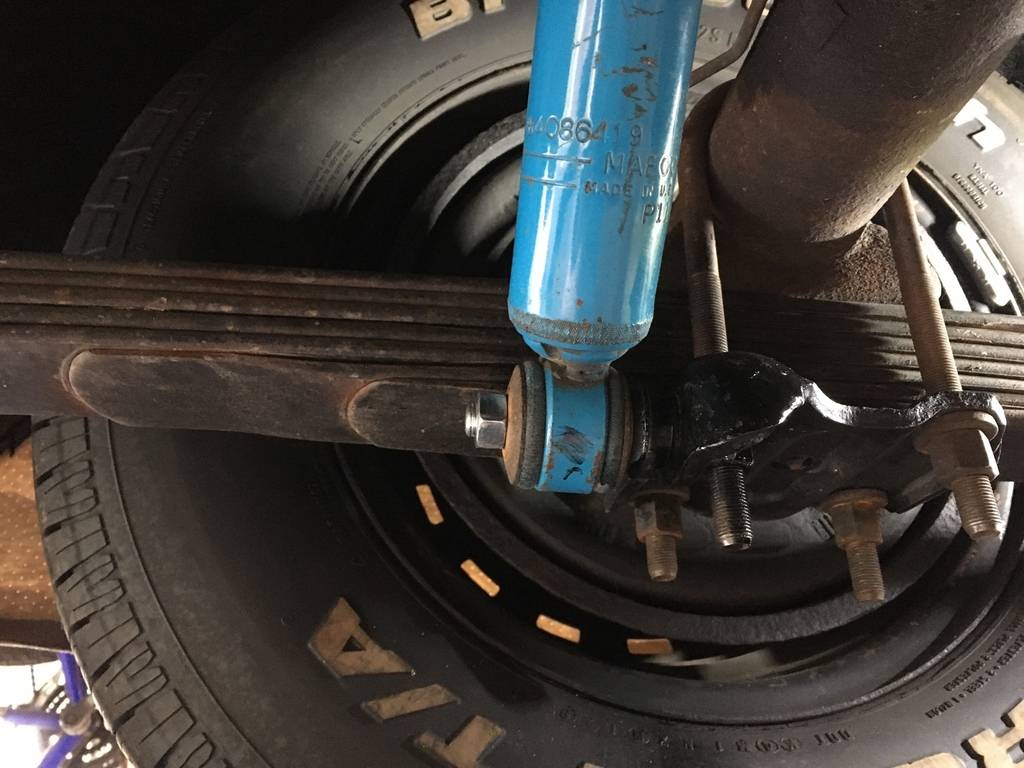

So, gotta remove the old stud. It looks like it's pressed in and possibly swedged over. I've never seen one come out, so we can figure it's not coming out easy.
First thing was to center punch a starting spot and then drill out the stud. Strated with a 1/4 drill and worked up to 1/2". The hole looks a little high, but it's really centered on the stud. The factory swedging is a bit offset though.
Just had to drill in a little over 1/4" deep.
Now, with a hole in it, I used one of my favorite implements of destruction, a Sawzall to cut the stud off. Drilling the hole first made this job a lot easier because the stud is hollow.
Cleaned it up with my trusty die grinder.
Done! An hour's time and $6...

So... I looked around for a lower spring bracket. Come to find out, the bracket is the same as the B and E bodies, so I guess that makes them made out of gold....
What about the "A" bodies brackets?? It would seem to me as basic as these brackets are, I would think they'd interchange between all models? Kinda like a voltage regulator, or lug nuts.
A body brackets for a 7 1/4 are smaller. The axle tube being smaller in diameter uses a smaller uses a smaller u-bolt, so the spacing on the bracket for the u-bolts is smaller. I could find those cheap all day long.
BTW, A body lug nuts are 7/16.
Generally speaking, B, E, and C (with no insulator) bodies use the same bracket. Probably an A body with a 8 3/4 uses the same bracket.
