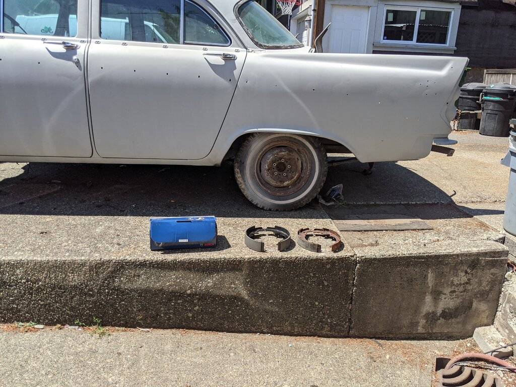

So I recently installed a 8 3/4 rear end out of a 1968 polara into my sons 1956 Custom Royal
it needed new brakes so I ordered some from rockauto.

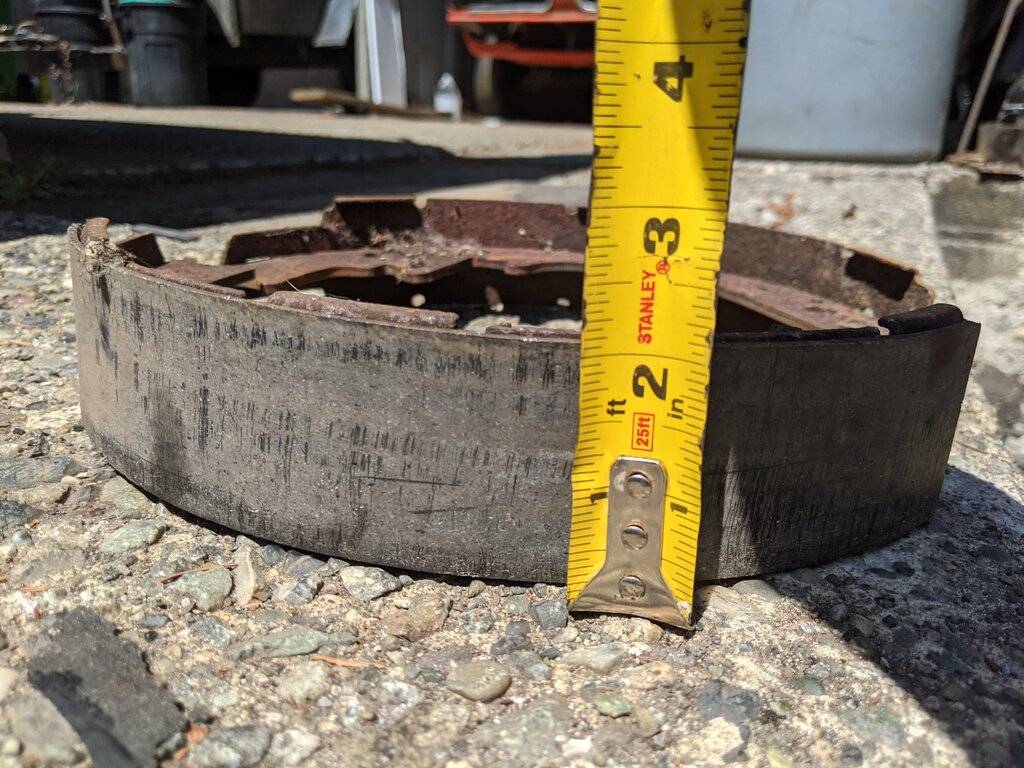

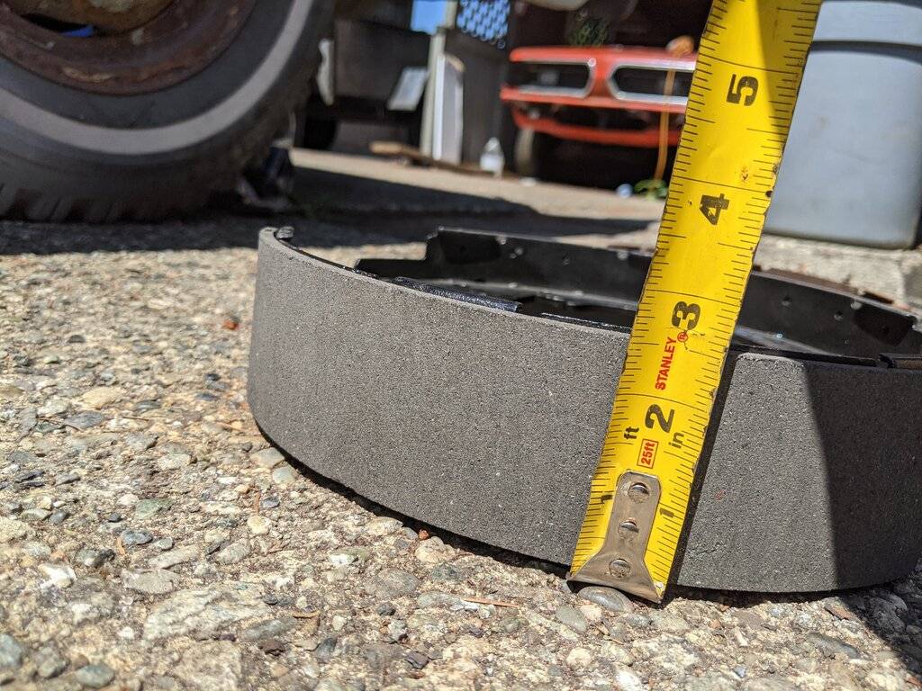

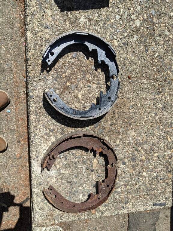

I could not find any 11 x 2 shoes so I went with some that were listed as not for heavy duty brakes but they did not list the shoe size. The shoes that came off of the car were 11 x 2 The ones I got were 11x 2.5.
Question did any c body cars come with 11 x 2 rear drums?
I posted some pictures for reference.
Also what cars did come with 11 x 2 drums because I definitely have old 11 x 2.
Thanks
If you had 11x2's the 2 1/2's definately won't work. Dang, I wish I kept my old catalog rack from the parts store.
yes i ordered everything new wheel cylinders, shoes, adjusting screws, spring kit, and e brake cable. At this point it's probably best to find a proper backing plate from that'll accommodate all this new stuff. Very frustrating. C'est la vie!
Mopars used 2" shoes on the rear for a lot of the lower performance models. craig@mobileparts, a vendor on this site, usually stocks the correct 2" shoes.

11x2 were installed on Canadian Fury and Polara with slant 6 and 318 engines.
