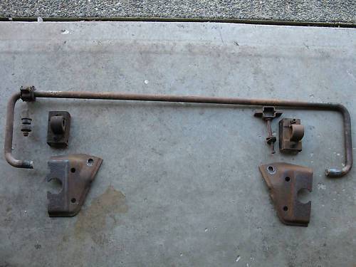

Anyways, the C body sway bars I saw were both like what you see below, half brackets that could be added/ stacked onto the iso clamp (note the large hole). Same style as the early B body rear sway bar offering.

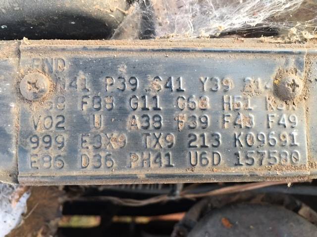

The 1977 Sales Code for a rear sway bar was S41. Actually I find that code on several, but not all fender tags for 1975-1977 C-body police cars.
1976, ex North Carolina Highway Patrol:

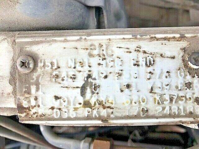

1977, ex Royal Canadian Mounted Police
But this 1977 ex Colorado State Patrol doesn't have one (S41 would have been stamped between N96 and END):
