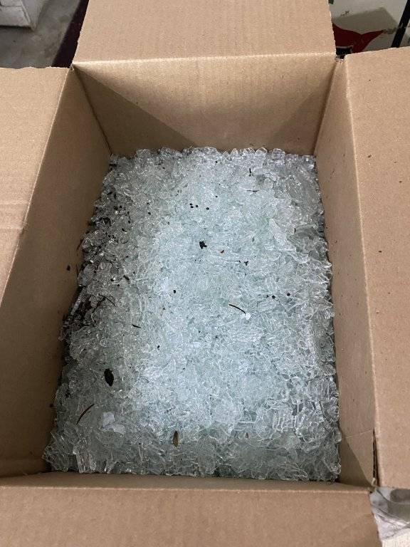

Well the weather in BC has turned nice, so time to take the 300 convertible out, went to put the top down in the garage, and blew the rear window into smithereens! Original Glass tinted window made it through 5 plus decades but now gone. Don't know what the hell happened, nothing in the trunk or in the top boot, just glass all over the fuc&%$# place. I am sick! Now the search for a replacement. Anyone have any suggestions on where to start, or what other models had the same rear window? Would you replace with a plastic one or a lexan one or something else if a glass one cannot be found? Any hints would be appreciated!
BTW, if any body needs any parts for their rear window, I have a box of very small ones.

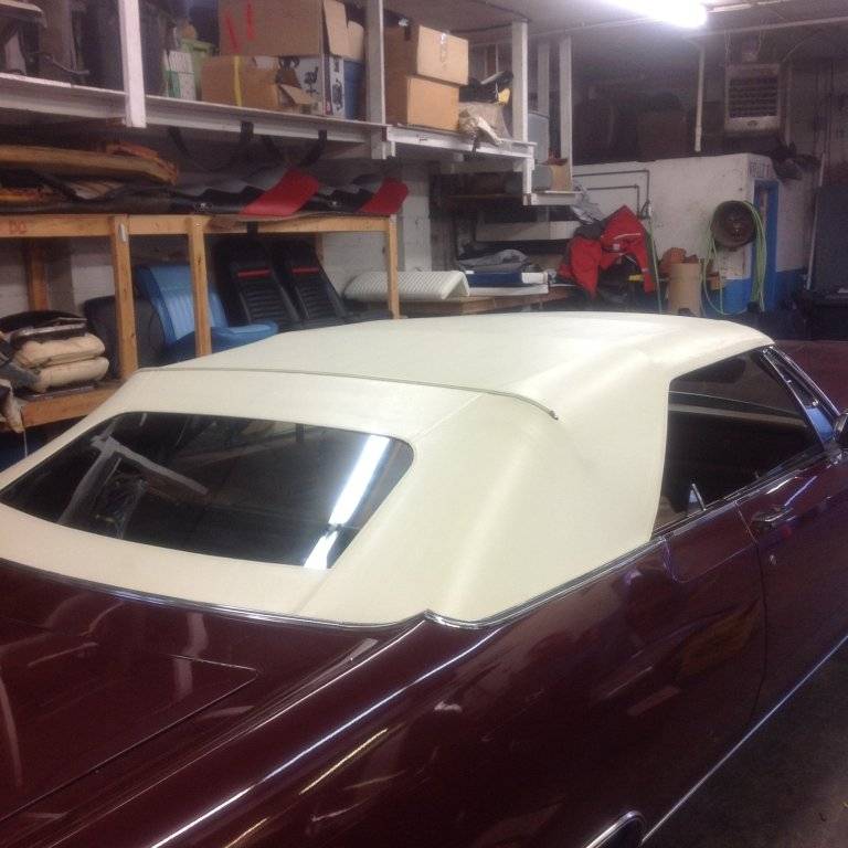

Here's a thought, give these guys a call. They are supplying replacement tops with new glass. I wouldn't try the lexan as it will scratch easily.
Chrysler Full Size, 1967-68 Newport, 300, Fury, Polara Glass Window Section (#TN151)

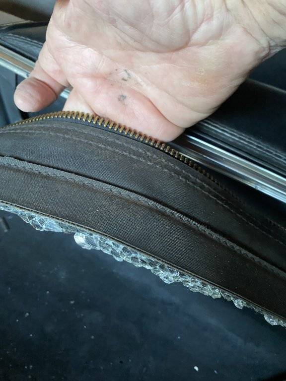

the convert back window can explode from stress as the top ages and contracts,
my 70 300's rear window exploded as i undid the passenger side clamp.
i got a new top and rear window installed here in victoria.
a used back glass is already bonded to the existing surrounding material in order to install it.
i dont know that you can re-bond glass to a new surround;
the shop that i use ( friends who i trust and who work on some very expensive restos) say
the problem is that the rear window and its surrounding material is cut to work with the top
that is on the car.......... so a used 1 wont fit right and could shatter
good luck, hope you can make a used 1 work
Is the surround glued to the top, or zippered into a special feature sewn in when the top was made?
Unfortunately, the surround is glued to the glass along the top and down the sides. Upon reading up on this, and listening to other members stories and opinions, it would seem to me that it would be almost impossible to have a used window installed in the existing top, and I may very well have to have a new top and window made as a unit. I don't know how anyone could reasonably removed 1000 small shards of glass that are glued to the fabric along the edges of the glass. I have no idea who did the top that I have, it was before I owned the car, but the top maker sewed in a 1 inch flap about 4 inches from the zipper, and glued it to the window across the top and down the sides. It is a contiguous piece, so I guess it could be taken apart and resewn, but that seems likely to be tough to make the window fit properly. Have to do some more thinking on this.
