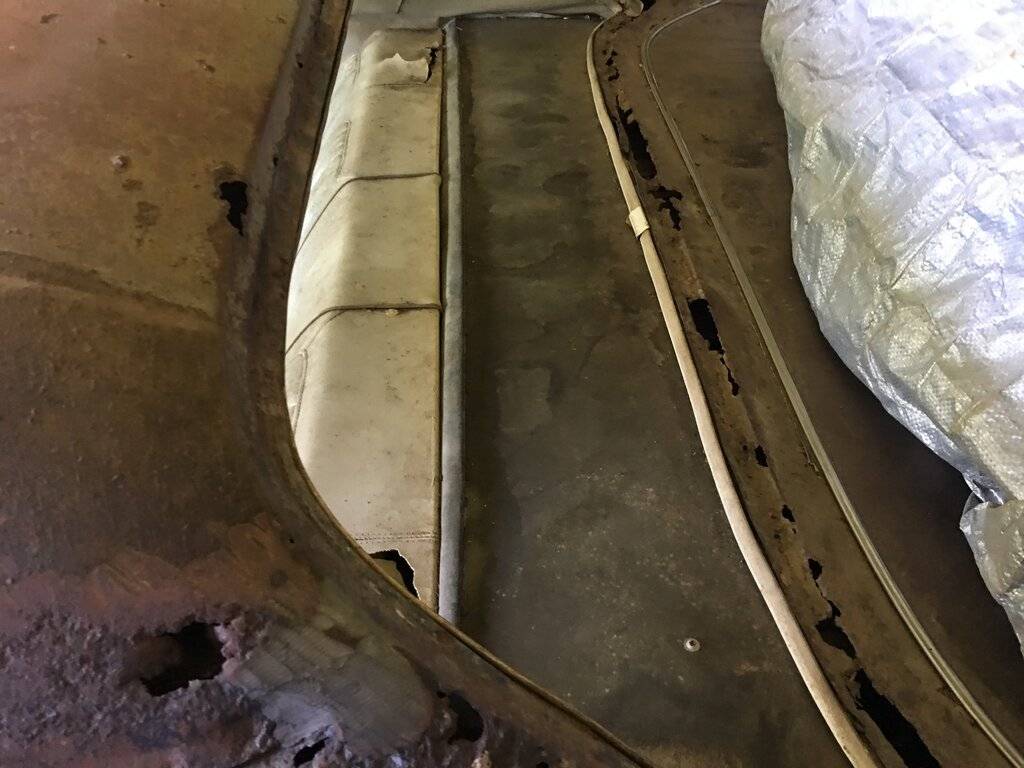

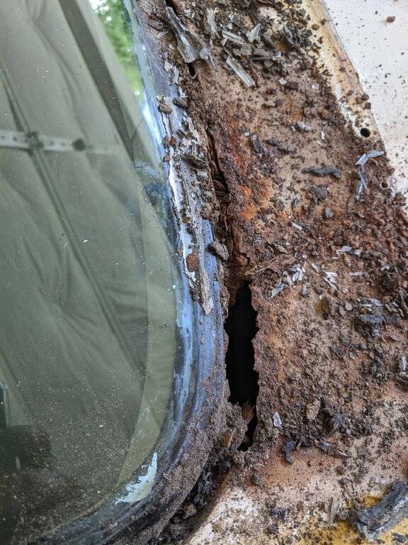

I’ve had my 1970 Fury now for 5years it’s time to either do something with it or sell. The car is very straight with little rust but the rust it has around back window is bad. I’ve looked all over internet to try and find parts like window channel but had no luck does anyone know of any company that makes anything for it?

I don't think you could find one for this roof style. They all rotted terribly. There's a super solid 4 door in Hidden Valley junkyard and it's still rusted around the rear window. Also doesn't matter if the car has a vinyl roof or not. There's a secondary panel below the dutchman, and that will rot out too on these. It's a pretty big deal to repair. Going to be much more work than MattfromMaine's Newport.

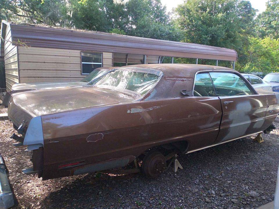

I bet that's why someone gave up on this car:
NOT MINE - 1971 Plymouth Fury Coupe - Parts Car - Tampa, Florida

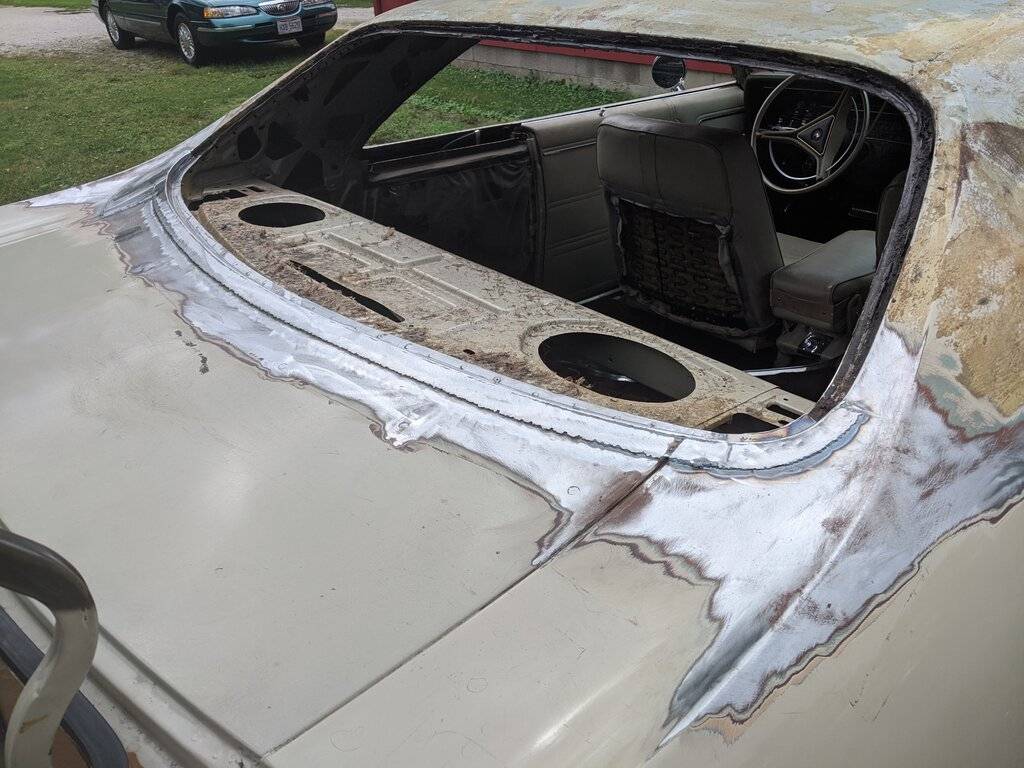

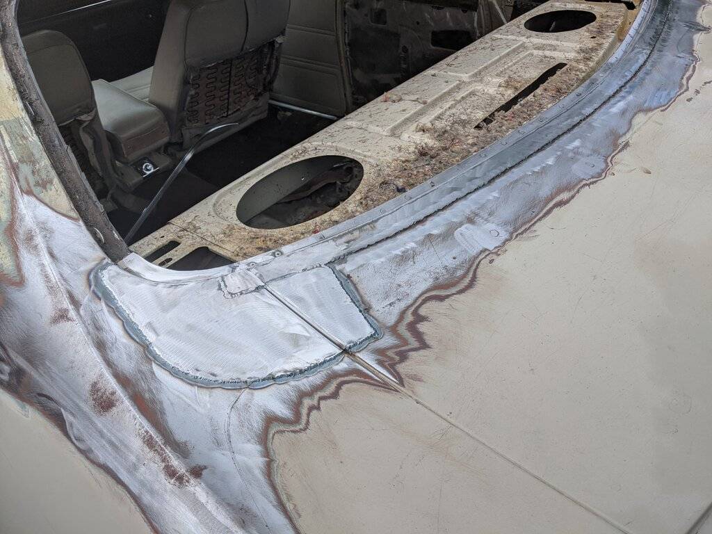

Well, In the Toledo area, I used Chris Dixon. He used to work under "wounded knee" , has quite a background in hot rods. Pm me if interested, and I can reach out to him. He's pretty busy
Go to a coach builder,busses and stuff,I did a trade in it,they can make anything with sheet,you really want one to do a cashy,I’ve done front roof rails to what you need,not that hard just need equipment,good luck
