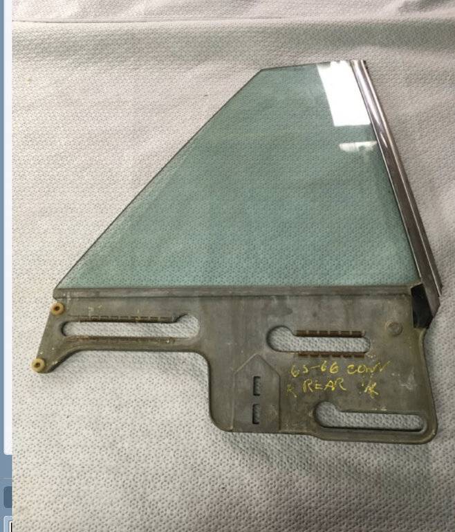

So what is used to keep the glass solid and stuck to the bottom bracket?
There is a rubber/ butyl tape. When I re did mine I re used the original rubber tape with some black sealer.
