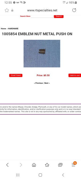

I have found these to work very well for this exact issue. You can get them from R/T Specialties
That style of emblem retention was used by the later 1960s, but are not too easy to remove the emblems without breaking the studs anyway. Usually used where rear access was not available, like on sail panels and such. Less labor on the assy line, too.

I took your advice and went to NAPA today and bought the push on emblem nuts like MoparMike has pictured and 3M trim tape. I did the first 5 letters on the front hood. I did start with just the loose ones but the tape does make the letters stand a bit more. So I'm doing them all. No more worry about them rattling off!
