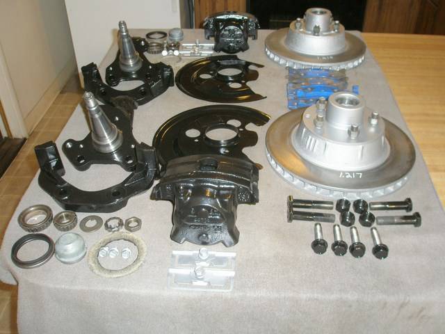

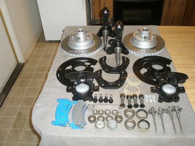

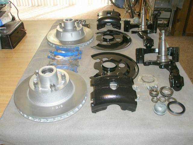

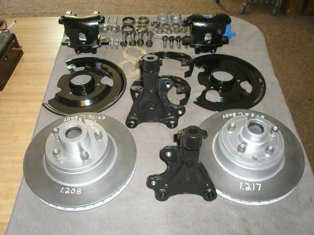

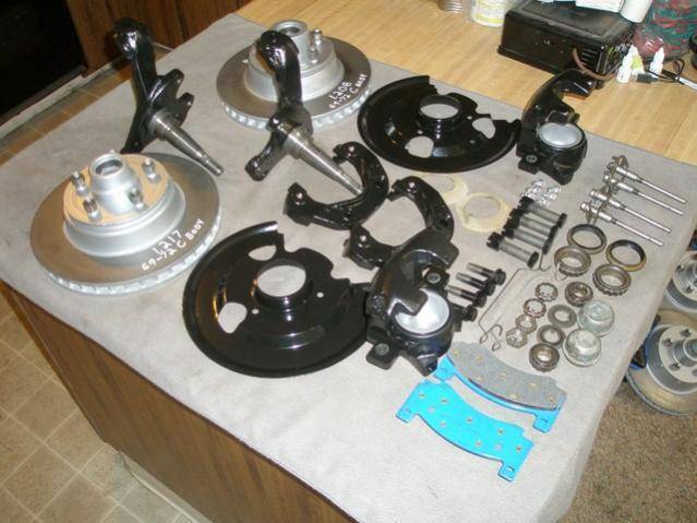

I have complete Disc Brake parts for the full size Chrysler, Dodge, Plymouth, "C" Body line of automobiles.
If you want to convert your 1960's early 70's land yacht, to disc brakes, i have the parts and pieces to get it done.
I have collected, horded, saved, rat holed, various year parts, that all will work on a drum brake, to disc brake conversion.
1. One set up is from the 1969 - 1972 cars.
2. One set up is from the 1974 - 1975 and up, cars.
The difference between the set up's is mainly the diameter of the inner wheel bearing in the rotor, and either "slider" type, or "pin type" calipers used.
I also have the disc brake proportioning valve used, needed, for and used, with these brakes, that i can also put up for sale, if wanted, needed.
Everything was disassembled, hand scrubbed cleaned, in the solvent tank, of decades worth of grease and grime, then soaked out in a 5 gallon pail of a product called EVAPORUST, to bring them back to bare metal condition.
Then everything was painted up, ready for me to reassemble.
Now that i have done all the labor to bring these parts back to like new condition, i will be selling these sets at $450.00 each.
These are the last two set up's of "C" body disc brakes that i have left.
At one time i had 5, and now down to 2.

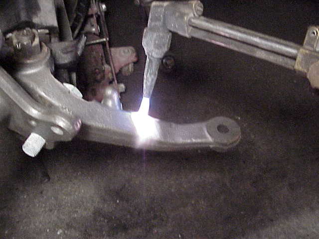

This guy did it, and wrote the article, on how it's done.
Wether it works for someone else, that's up to the individual, wanting to do the changeover.
Nothing is written in stone.
Disc Brake Conversion to 1961 Chrysler 300

If it includes the 73 spindles then no, you should not have to heat and bend the arms as shown in those photos because they are demonstrating how to use the 74 to 78 spindles

Not sure I like that heat and bend deal.
On a 61 Chrysler.
