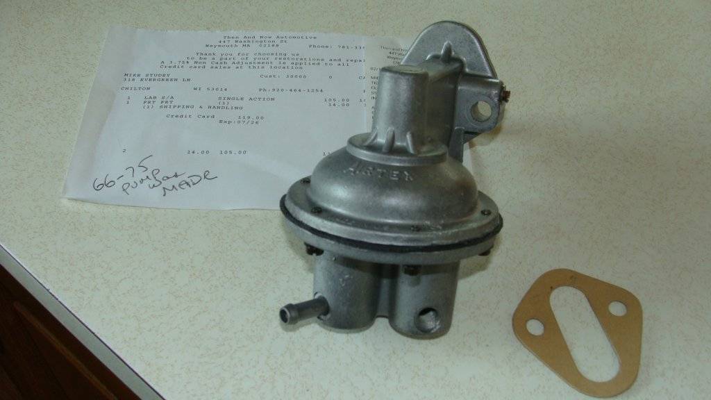

Hi, I had my Airtex fuel pump rebuilt by "Then and Now" in Mass, turn around time was 1 week and price was $109.00 plus shipping. They informed me that this model pump was made 1966-1975.
These were a really good pump in their day. Hopefully the rebuilder was able to source a diaphragm that is resistant to blended fuels. That was the main issue causing these pumps to fail. Ethanol blended fuel eats up the internal rubber parts in the pump.
Dave
From another forum, I believe that is the rebuilder that also does lots of "antique" fuel pumps, using the ethanol-resistant diaphram material. KEY thing is to not let the diaphram dry out during times of vehicle non-use. It is claimed that once that happens, even with the e-resistant diaphram material, the diaphram will get brittle and later fail. Just relaying the information from the other forum's thread on rebuilding fuel pumps.
