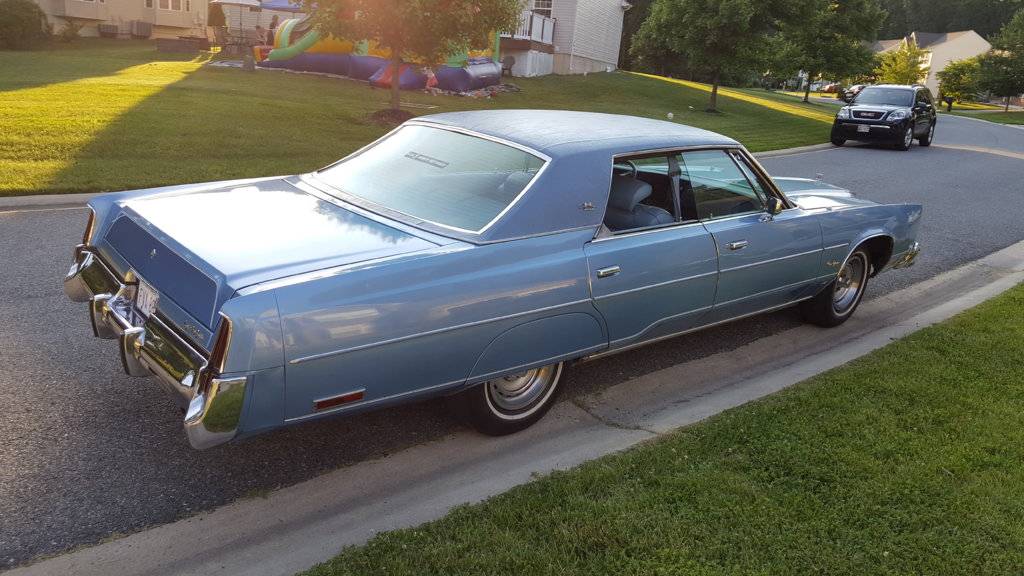

anyone had success recoloring a vinyl roof? If so what products did you use?
I have seen duplicolor advertised, but mostly seem to be used on internal vinyl.
Thanks
