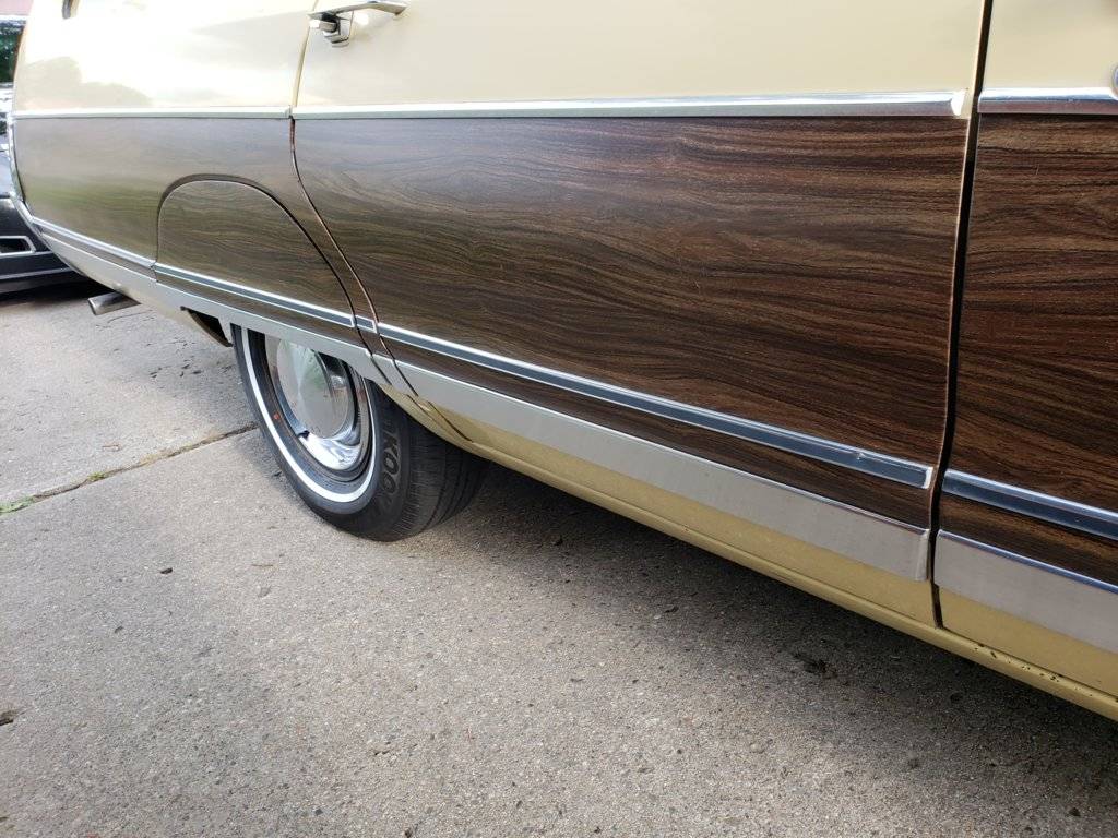

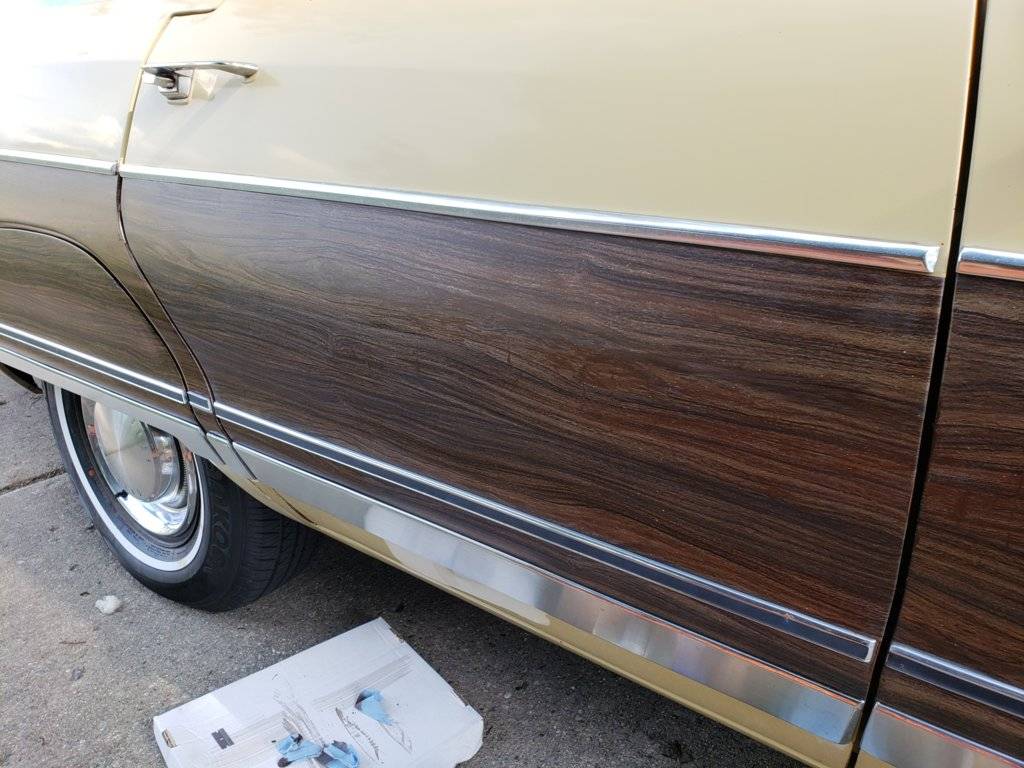

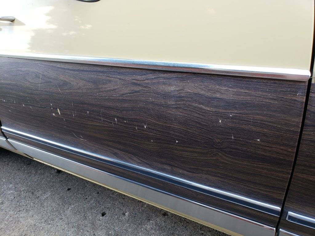

I'll explain how tomorrow...but here are before, during and after!

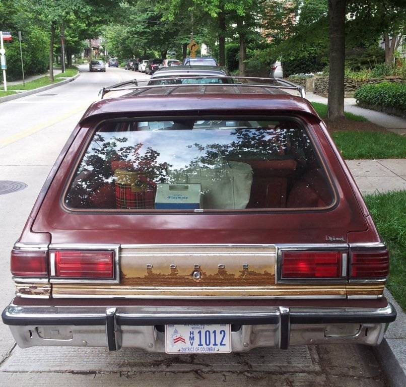

Can you do the same for my '79 Diplomat wagon? The paint/body has aged reasonably well, but the woodgrain has NOT...... have been entertaining the idea of replacing it, but am otherwise REALLY hesitant to open that can of worms.

after wiping everything down thoroughly with wax and grease remover, I began the painstaking process of filling in any imperfections. I'm talking about the nicks, scratches and cracks that penetrated the vinyl down to the paint.
Using a tiny brush, I filled in those imperfections, doing to light coats instead of one. In the future I would even consider using two shades of brown. But as I was in the process of painting, when I stepped back from the car approximately four feet I could barely even tell where the repairs were made!
Once I got all of those filled in, I needed to address the bigger problem of fading along the top edge of the wood grain. I mixed the espresso spray paint with the matte clear spray paint and diluted it a little with lacquer thinner. Using a 2-inch brush, and after practicing a lot on a piece of cardboard, I applied multiple thin coats in a wood grain pattern. Because there was not a lot of pigment in my concoction, I was able to gradually darken the wood grain to the point I thought it was Blended properly.
The last and final step... Masked everything off and applied a nice uniform coat of matte clear.
I had a great time doing this! And I'm more than thrilled with the results! I don't see why this wouldn't last at least a few years, and I will update the thread if anything changes. I'll be tackling the driver side in a couple of weeks, but it's nowhere near as bad as the passenger side was.

Trouble on the vinyl/dynoc on mine (as you can tell from the rear pic) is widespread fading, mostly in the rear and on the driver's side. I think your technique of using multiple coats of less pigment to gradually get it to match might work for me, but I'd have more of it to do. Still, it's better than trying to peel off/replace. I have similar trim surrounding the woodgrain on my to your T&C, which looks easier to tape off. MANY THANKS for putting this tutorial on here!
