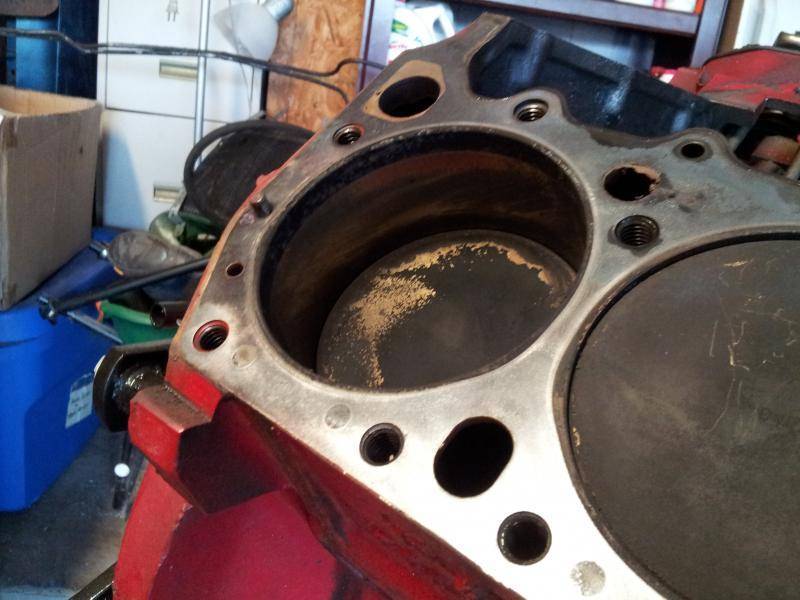

No problem. I've been doing a little homework on this before I'm make the decision to begin and came across this vid on youtube. Are these required for Chrysler blocks also (the dowel pins)?
https://www.youtube.com/watch?v=eRxW9Td37vI
20130410_191107.jpgThe dowel pins are already in the block. Heres a shot from my 440. You can see the small pin to the left of the cylinder. I cheaped out, and reused my head bolts. Granted I dont think mine are 40 years old.. Believe they were replaced in 05, with only 5,000 miles on em. I'd deff replace em if they are original.

I see em', much obliged. Just about certain I'll be safe than sorry and grab new bolts.
