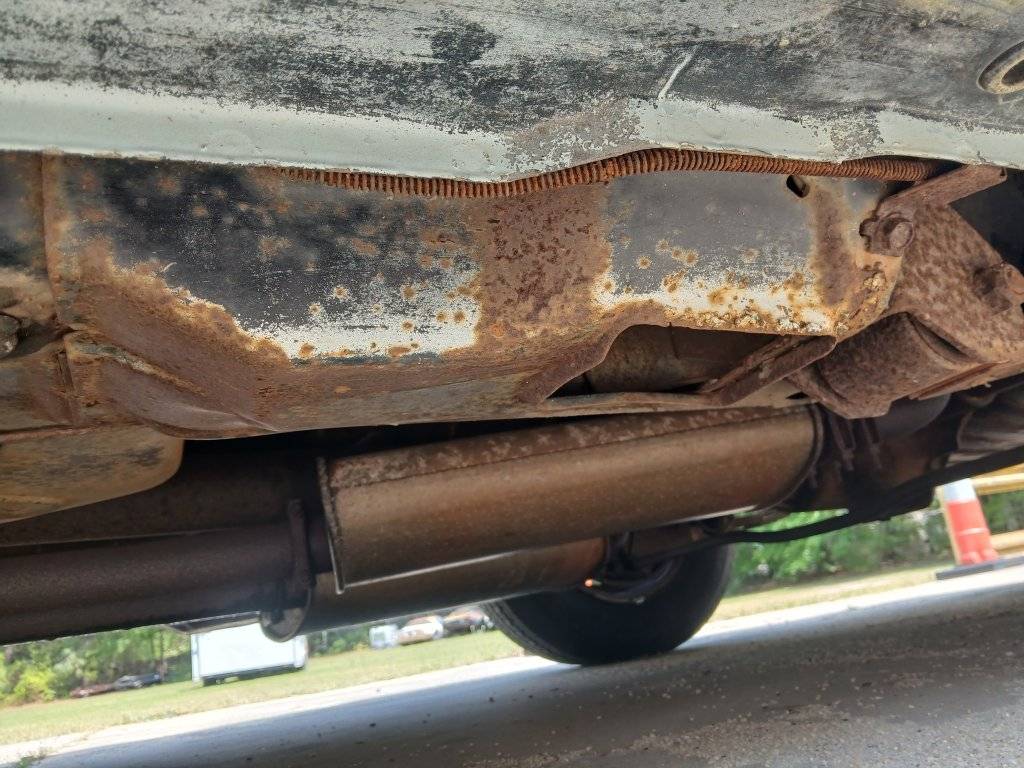

The extra rocker reinforcement can be seen here.
Hardtop without reinforcement.
Convertible with reinforcement.

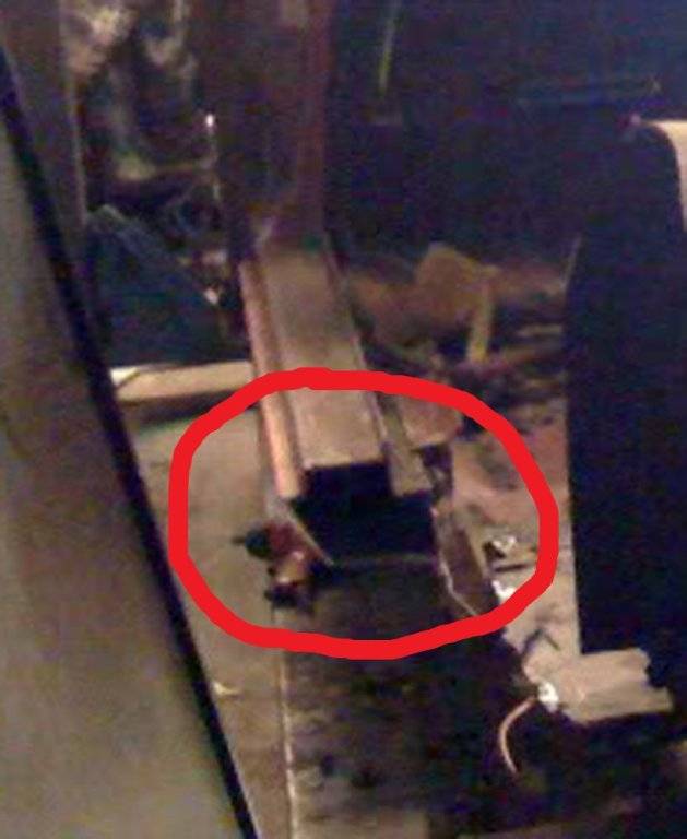

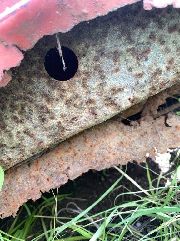

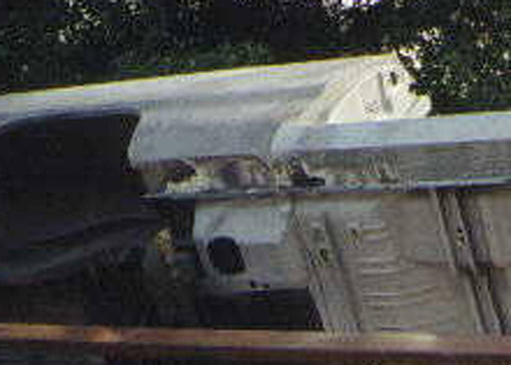

The torque box is just an additional piece of sheet metal that helps tie together the rocker, rear frame rail, the main crossmember under the rear seat, and the small crossmember that the leaf spring bolts to.
It is a plate that covers the bottom of this area.
The oval hole provides access to the nuts that hold the spring hanger to the frame.

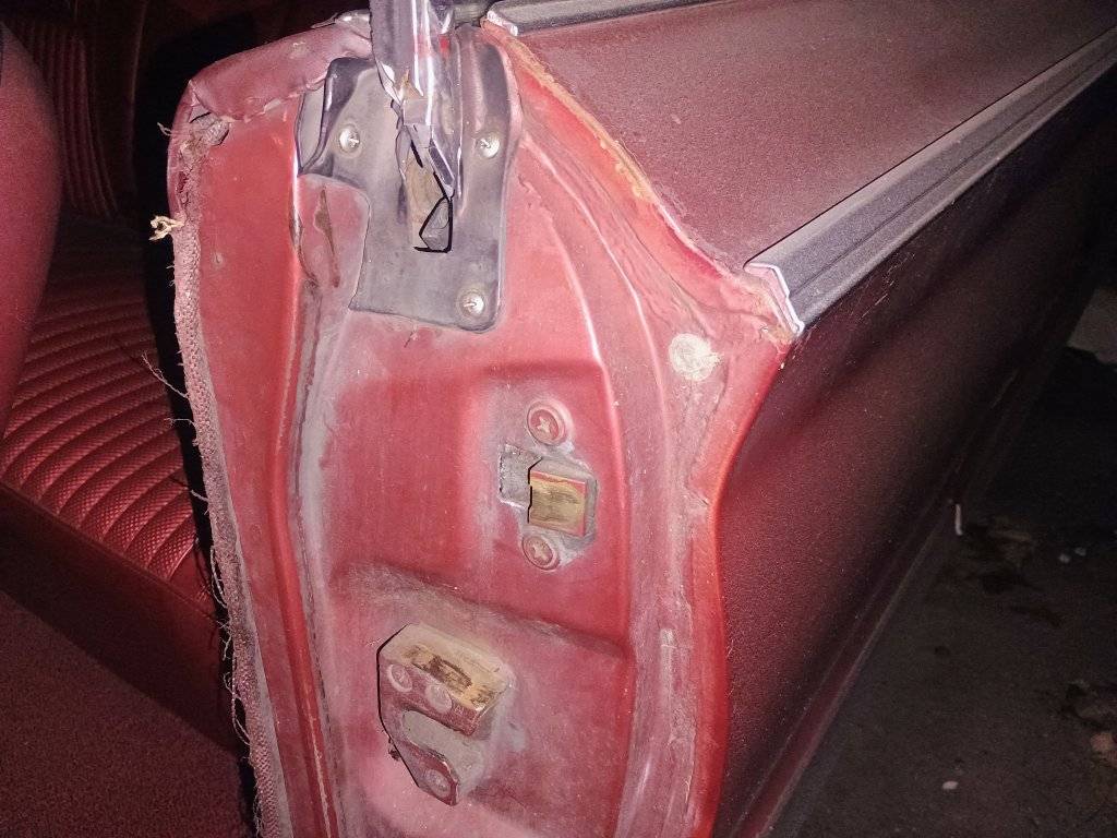

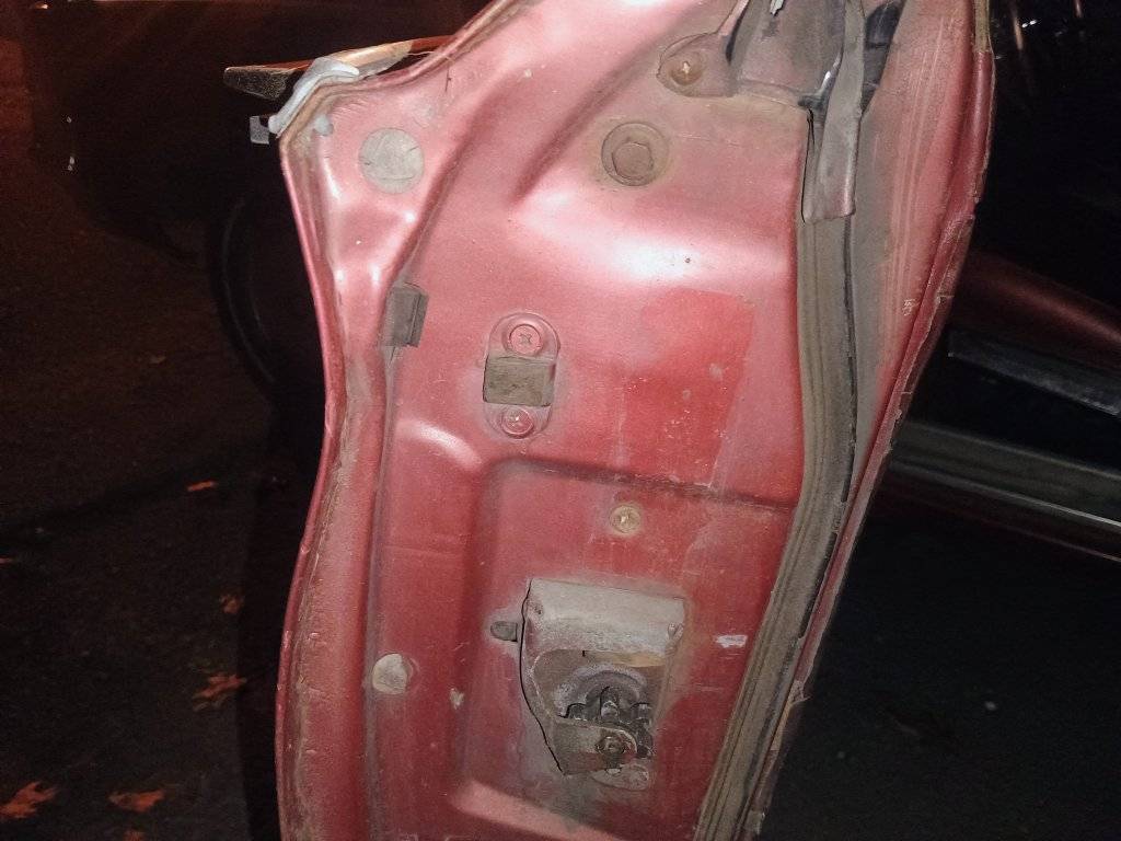

I couldn't find any picture online of the door wedges, so will get some from my car later.
Door wedges
Fixed wedge is fastened to the door.
Spring loaded wedge is on the jamb.

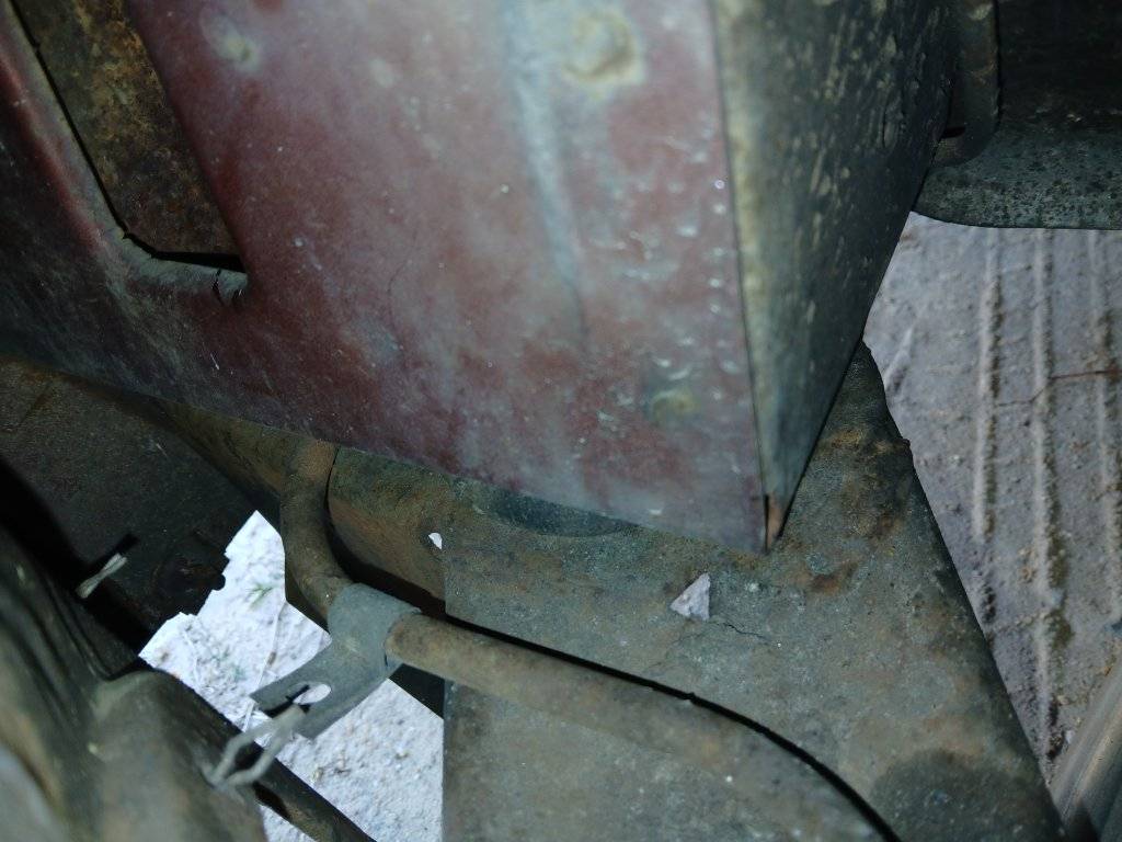

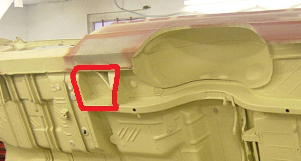

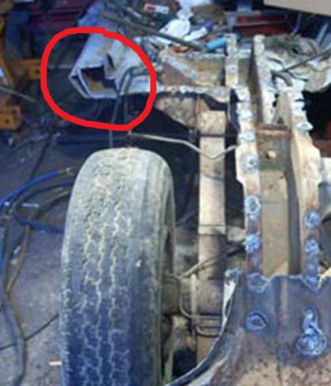

This is a good question, 74-78 c bodies it seemed like more so Monaco and gran fury had a special piece of angle iron on the bottom side of the stub in between a arm and the fire wall mounts. Does anyone have a reason why that is or is a 74 only thing. It's hard to find them that have it!
My 1977 PK41's didn't have any angle iron so to say just added flat reinforcing plates welded to the top and bottom of the frame rails that I learned long ago way before the Internet was to keep the 'Crush Zone' from entering the passenger compartment.
I have seen a few and it was definitely angle iron and yes it was exactly where they bend on impact. Just curious why there was so few that had that done and not all of them. Seemed the very very few I've had it done were all on 74's

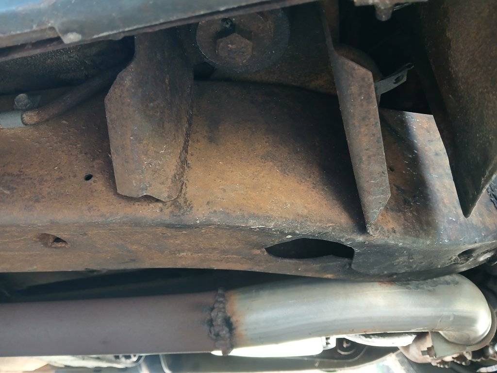

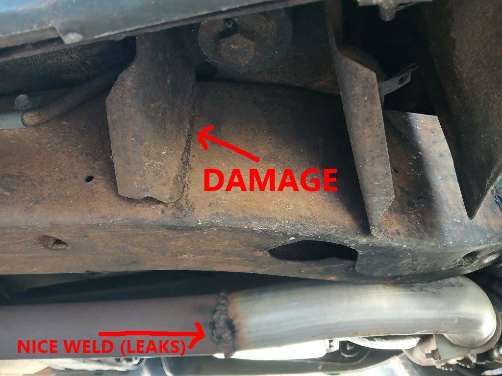

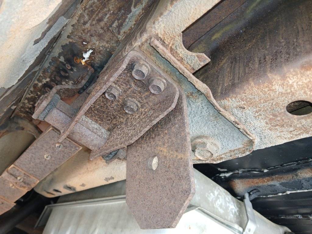

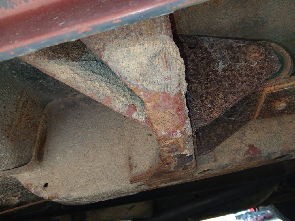

Here are some pictures of the mentioned areas on my car, it's a 77 PH41 A38. I didn't see anything directly behind the upper control arms, but there's a hollow box where the frame meets the firewall with some metal gussets on it. Also one at the front leaf spring hanger. The rear hanger has what looks like tow hooks as well.
And according to the fender tag it has A pillar spotlight reinforcment.
I had these on my 2 1977 PK41's but they weren't on my 1976 Gran Fury Brougham 4dr sedan.
My understanding way back at the time (1980's) via the Service Manual(?), Owner's Manual(?), word of mouth(?) was that it had something to do with towing and the 5mph bumper. Tie down for factory shipping or ramp truck tow? Who knows, but why the 1976 Gran Fury and other civilian cars didn't have them is... All I know is when I saw them and if they got to be a annoying head bump while working under the car I thought about removing them but being tied to the spring mount could be a PITA to remove... but I did have a cutting torch. Well twisting my brain some more I think I recall in the Service Manual is that they had a towing diagram for sling mount tow trucks where you used wood blocks and these mounts with chains to keep the sling off the 5mph bumper to prevent the tow from collapsing the 5mph absorbers. I just had a look at a 1976 Owners manual and saw nothing of this in the towing a disabled car section so it's got to be in the Service Manual. Since my 1977 Service Manuals are long gone and I've found nothing free in a .pdf format and prices of $100>$150 I'm kind of beating myself up about throwing mine away, but then again I couldn't sell or give away all my spare Mopar parts back in the 80's.
Shudda used a Oxy-acetylene torch on that pipe and you wouldn't have any leaks, and in some states that require a all welded exhaust system those leaks would be a failed state inspection.
