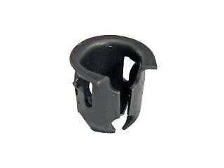

I looked in the parts book and they don't show a good illustration, but they list clips instead of nuts.
"Clips" might be illustrated in the "Standard Parts" section of the parts manual, but probably are of the "insert" type which is placed in the hole and then the "pins" on the backside of the molding are inserted into them, to retain them. Personally, as those clips can chip the paint when they go in, I might opt to use some well-trimmed 3M molding tape to secure them instead. Might not be "correct", but would ensure "one more area" where rust might not happen in the future. PLUS easier to remove should the need be.

I believe you are correct. They are called barrel clips in our locale. Absolute bear to remove unless you have access to the the inside. Easier to put in place than remove.
