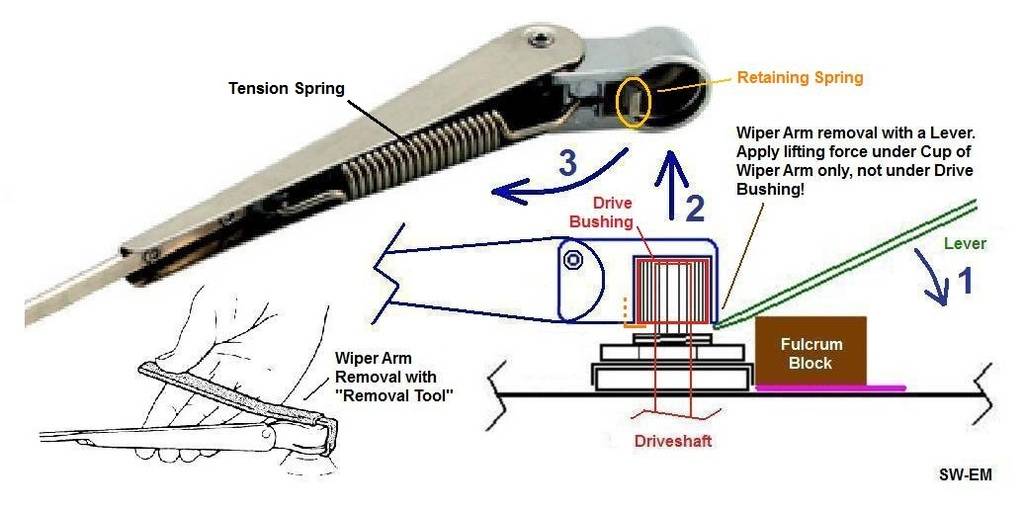

A little spring tab in the wiper arm has to release from the groove in the post. There is a special tool, but if you feel with your finger (it's usually under the actual arm side of the post), you will find it and then no need for the tool. Use a small screwdriver to move the tab away, while carefully pulling up on the cap from the other side (opposite the arm). Be careful, as it can pop off quite suddenly.
Here's a generic picture of what it looks like:
