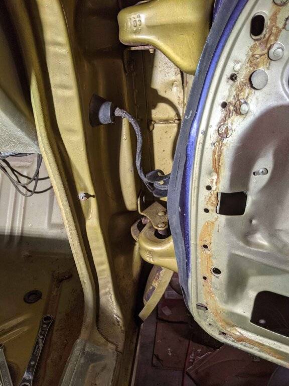

Both front doors will not stay open on the '65. Replaced the springs (which were MIA), but they still won't stay open 5 out of 6 times. Done some research and it appears the the pin/roller if the likely suspect. I can't see or feel if the roller is present or not.
My question is: Do I remove the front fenders (or doors) to replace them? It looks like it would be next to impossible to install a new roller and pin without removing one or the other.

Replacing Door Hinges: I am not experienced with working on a 1965. However, in 1969 and later, the spring is on the lower hinge. You can access the hinge bolts for the doors, by opening the doors. As long as you don’t remove the upper hinge, and properly support the door panel with like a wooden block on top of a hydraulic Jack, you shouldn’t have to remove the door. Further I can see no reason to remove the fender to service the door hinges. Hope this helps!

Further investigation shows that the roll-pin is broken and the roller is long gone on the passenger side. Don't know about the driver side yet.
Fabing up new rollers with a 5/8 bolt (as per an older thread).
I'm unclear about how removing the door panel will gain access to the hinge bolts as the bolt heads are on the back side of the hinge which makes them in-accessible with the door open. I do know that on A/B bodies you could remove the rear splash shield for access. Not so on the Newport.
I do know that there is not much clearance to remove the upper bolt on the top hinge with the fender in place.

Well it's Friday evening. The leaves are just about done for the year. The door hinge renewing is also just about done.
For the passenger side I removed the door. Not a difficult task, but you need to exercise patience (sometimes not my strong suit). I had some help in removing but not for the re-installation. A floor jack is a great tool for this. After some tweaking the door now stopping at the detentes like it did when it was new. All the gaps are good.
For the driver side, I experimented with some different tools so I would not have to remove the door as I am doing this solo. A 1/4" drive worked the best to removing some of the bolts from the lower hinge (door side). A 3/8" drive worked for the rest. I was hoping to leave the upper hinge in place. With the bolts removed, the lower hinge was loose however, it lacked the clearance to be removed. I ended up loosening the upper hinge bolts (door side). This allowed me to pull the door away from the hinge (supported by the floor jack) enough to remove the lower hinge.
Examination of the lower hinge showed the the roller was intact but the pin was broken at one end. This allowed the roller to be bent out of the way, rendering it useless.
I installed the new roller and pin and am now ready to re-install and align the door. That should take place tomorrow and, with Gods help, all will be good.

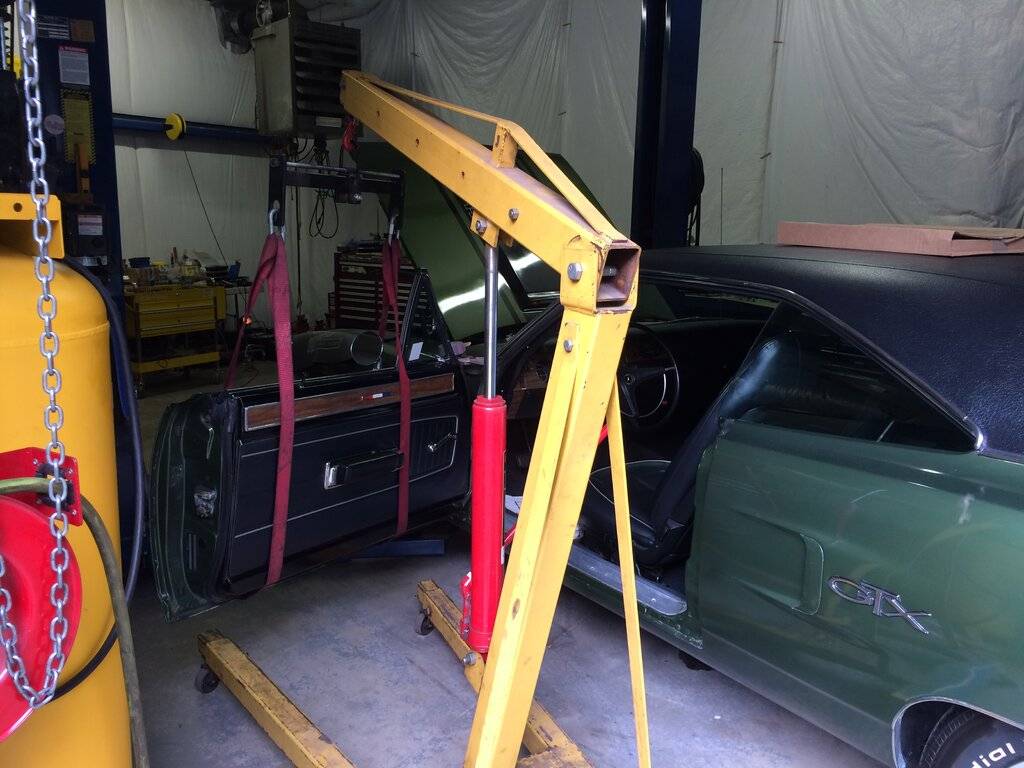

Sorry I'm late to the thread, congrats on your successful repair. Just wanted to share this tip for installing doors that I found here on the forum...I believe this is @bigmoparjeff 's idea and he shared the pic? The ability to tilt the door with the load leveler is great!
