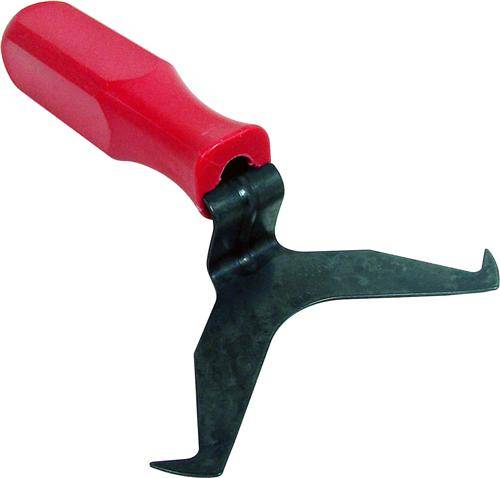

Here's the tool you need. It can still be difficult even with the tool due to the buildup of debris behind the moldings. It's called a Reveal trim tool.

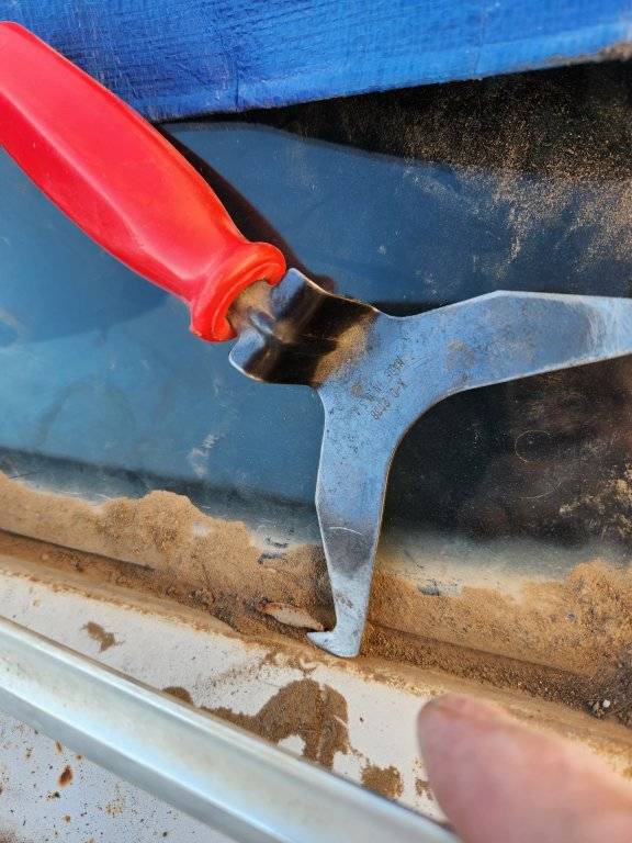

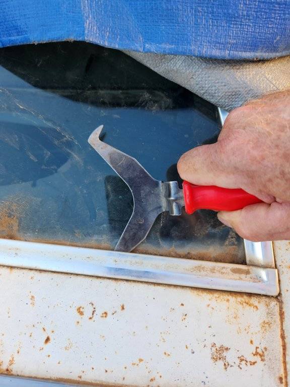

Stick the tool between the glass and molding and slide across until you find a clip. Then you need to hook the clip and twist the tool while gently pulling up on the molding.
