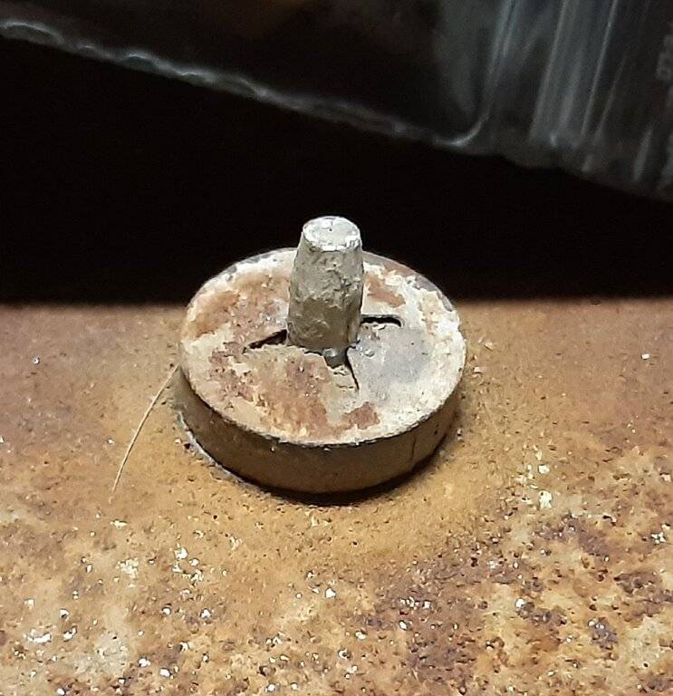

Yes, sorry, I meant a "push washer".
Here's a picture of it.
The panel stud is 1/4" and the OD is 3/4".
I just carefully pry a couple of the flanges up enough to remove. Then bent them back and re-install.
Another way is grab it with pliers or small vise grip and just twist it off as if it was on a threaded stud.
