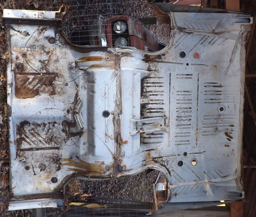

Ok...so I found a good trunk pan and he's going to let me remove it. He said bring a sawzall and generator to cut it out...but I'm thinking there maybe an easier way since its attached to the frame rails. My question is what would be the best process to remove the pan, extensions and lower quarters without damaging what I need or totally destroying the rear of the car? It's in a junkyard so I'm limited on tools and help. I need the entire pan front to rear. What has to be removed to get it out?

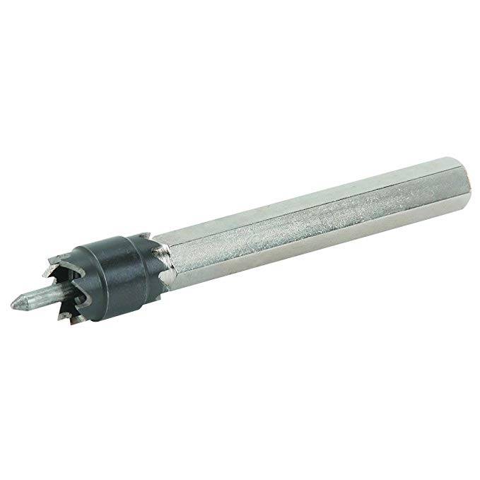

I believe the best way is to use a spot weld remover with a drill. I think there are several similar tools (one below). "Basically" you end up drilling small holes around the spot welds...and they are visible, but there's a lot of them. This technique will remove your panels un-damaged.

The spot weld cutter is good for keeping the base metal intact. I'm not worried about that here. I can't take the whole car. They sell parts not cars. I'm thinking a drill forthe welds on the frame members and sawzall for the rest. They would cut it out for me with a sawzall...I've seen some of the cars already....looks like that's the way. I will still try not to destroy valuable parts.
Keep in mind you will NOT be able to remove the trunk floor in one piece from the car without removing or cutting away the upper part of one of the quarter panels off, as the trunk pan is quite a bit wider than the deck lid opening.
If you do need to cut it into two pieces, have them cut between the two rows of spot welds up one frame rail, as it's a U channel. Then it's much easier to stitch it back together when you tack both parts to your car's frame rail, and you only have to dress one side after, as the bottom of the weld is hidden inside the frame rail.

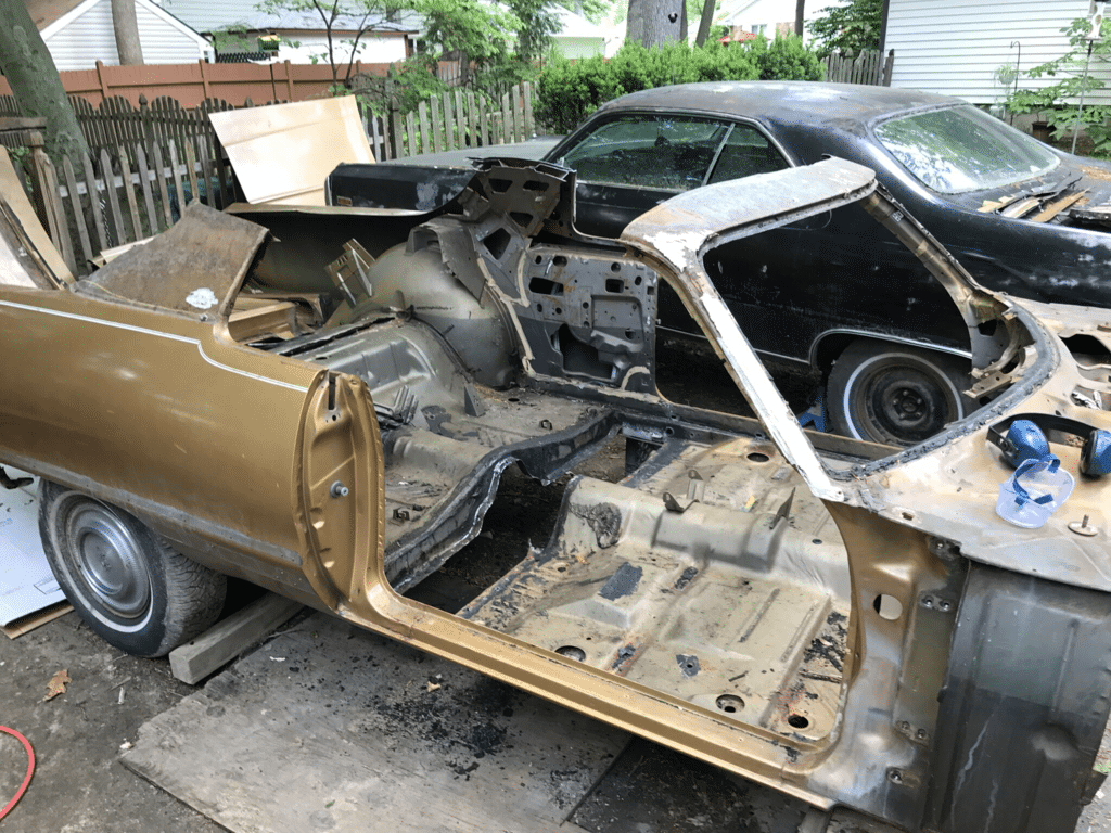

Cut the roof at the B pillar and up to the windshield, you will want some standing room. Use the spot weld cutter to remove the small section of the foot well of the rear seat, or just cut through it, there’s not much support under there. Then all that’s left are two rockers at the door lock pillar. Tow or rickshaw the entire rear out on the rear wheels, it’s actually pretty light at that point, assuming the glass and trunk lid have been removed. This was after about 4 hours of cutting. I used both a 12 inch sawzall blade and an air chisel, but I think it can be done with just the blade.
