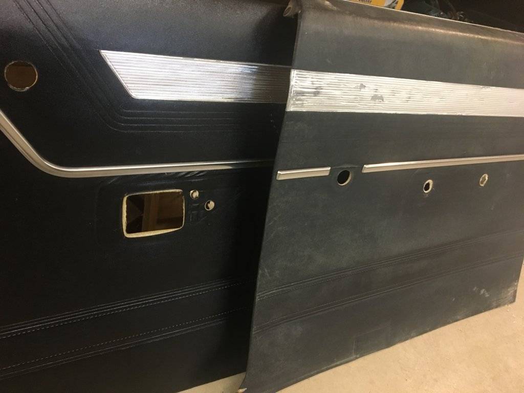

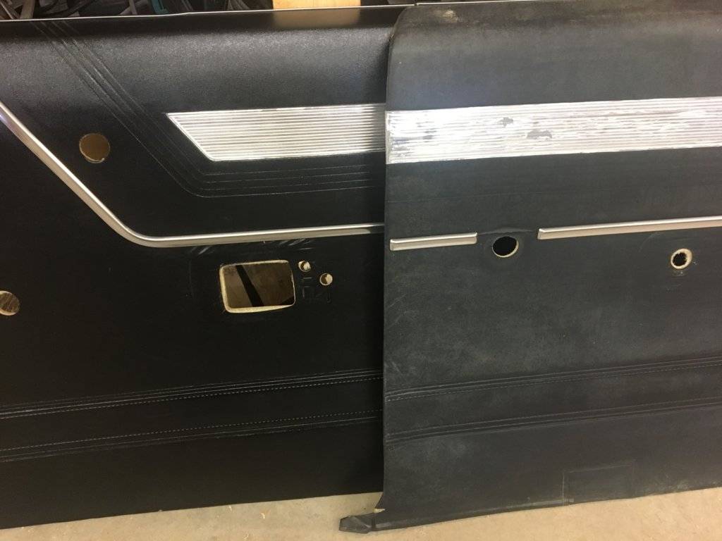

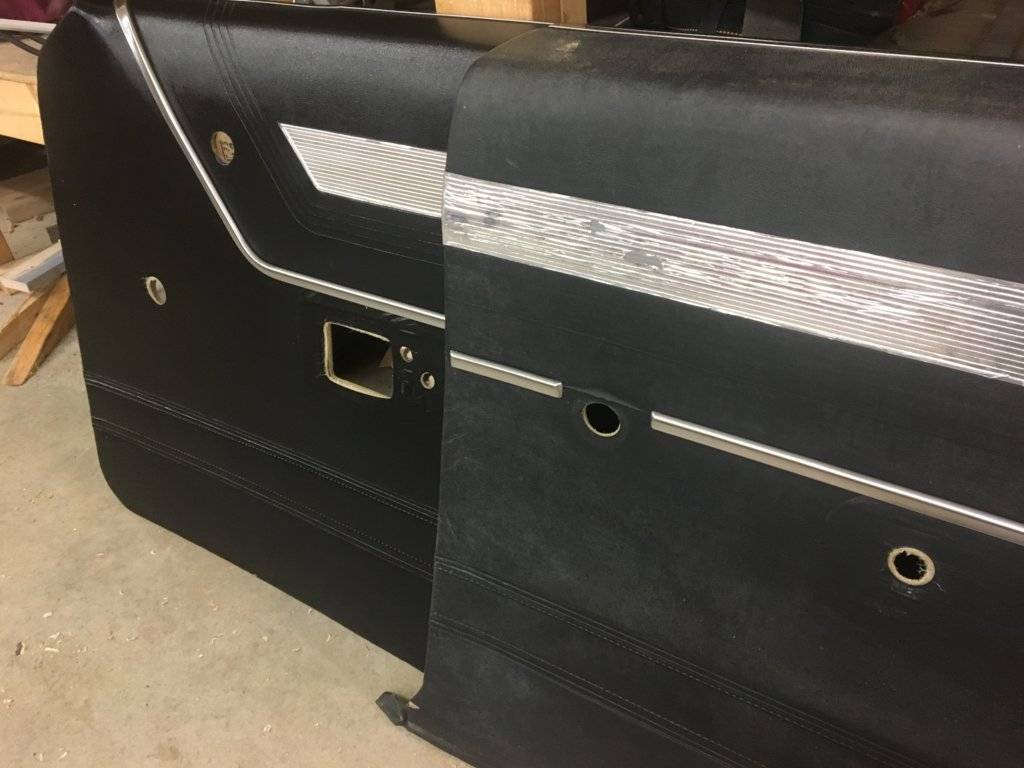

Can you see the difference?
I'm thinking of all options to fix this piece...trying to keep it original...but, want to give it that clean look.
