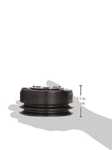

Has any one tried to to replace the bearings on the AC compressor and Clutch Assembly?
(Press old one out, and new bearing in, etc.)
Or is it better to purchase a refurbished unit?
I can't turn the shaft more than a half inch. the clutch assembly bearing is seized.
https://www.rockauto.com/en/parts/four+seasons,57059,a/c+compressor,6628
https://www.amazon.ca/Four-Seasons-48833-Remanufactured-Assembly/dp/B000C2QOSS

The compressor isn't sold with the clutch assembly
The compressor may have seized... meaning the clutch plate is frozen...
The pulley may have seized... which doesn't automatically mean the system is full of metal shavings, but often does cook the shaft seal of a compressor.
The repair you are considering is far different depending on which issue has occurred.

I separated the clutch assembly from the compressor. The bearing is seized on the clutch assembly, the magnetic coil is burnt and brittle and the shaft coming out of the compressor will only turn a quarter inch. Put an order for a refurbished compressor and clutch assembly. Will have a local shop flush system and recharge.
