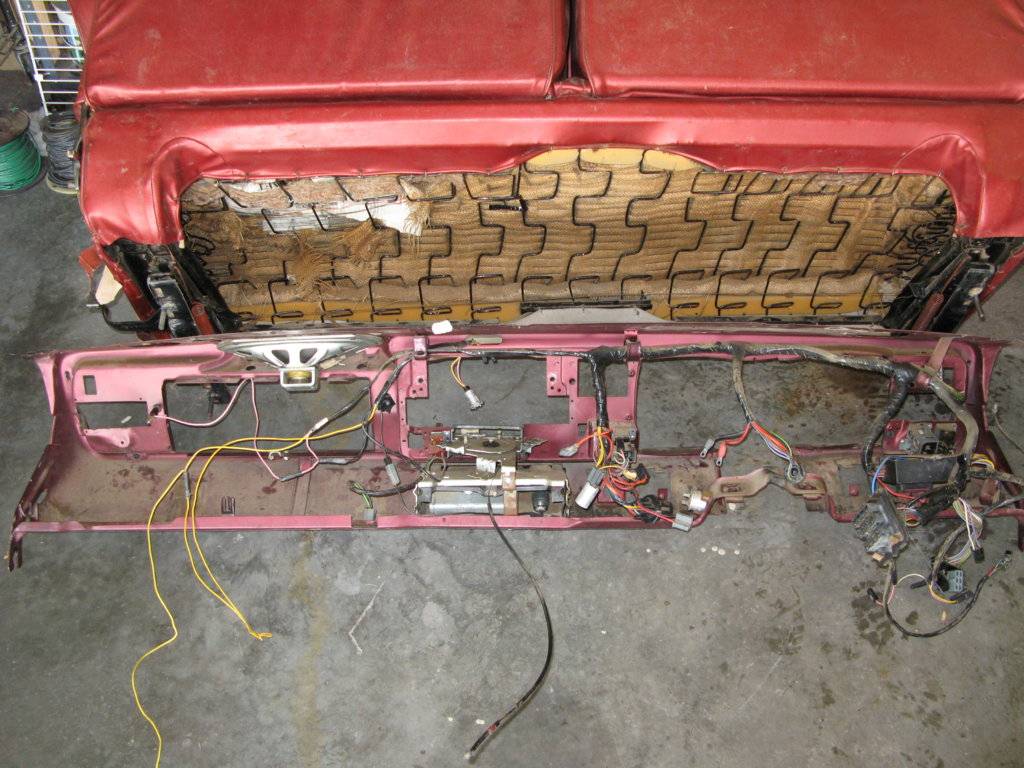

Not sure on a ‘67 Newport, but on a ‘68 Polara it is possible to remove the dash with the windshield in. Just barely though. You need a small hand wrench for the top bolts and push the windshield seal out of your way. What I don’t know is if you can re- install it. It would be difficult to get the bolts re-started.
Here is a picture of the back side of mine with the wires intact but out of the car for clarity. It should give you an idea of what you need to get to when you are blindly fishing the wires out.
If you can get the glove box and IP out of the way, you may be able to get it.
