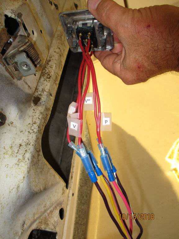

OTOH, I think it's the strange, crappy connectors inside the door panel that's the source of problems (high resistance or no contact at all). I had a dead window that I solved by doing this:
Quick, minimum-heat soldering on cleaned, tinned pins and tinned wire allows for work to be completed without dismembering the switch. (Note: I'm pretty good with a slobbering iron, YMMV). I did BLAST the switch with contact cleaner before the solder work. You'll notice I marked my wire colors for future reference. It's REALLY easy to get the wires upside-down on the switch due to the FSM diagram being "open for interpretation" depending on how you understand which side of the connector the diagram is portraying. (You'd need to have the door apart and the FSM diagram at hand to understand what I'm talking about) But trust me....after much preparation and care, during testing my window went up when it should have gone down and vice-versa. So, I just turned the switch upside-down and reassembled the damn door. Hell with future reference!

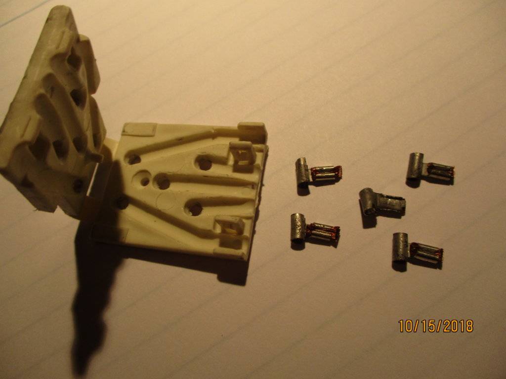

Here's the parts of the crappy connector inside the door panel, minus the wires, for those who aren't familiar with it. Old technology that worked okay when new, but not after the door panel has been removed a dozen times since your car left the factory. Those circular "tangs" were worn out and useless for transferring sizable electric current. Solder works goooooood.....
