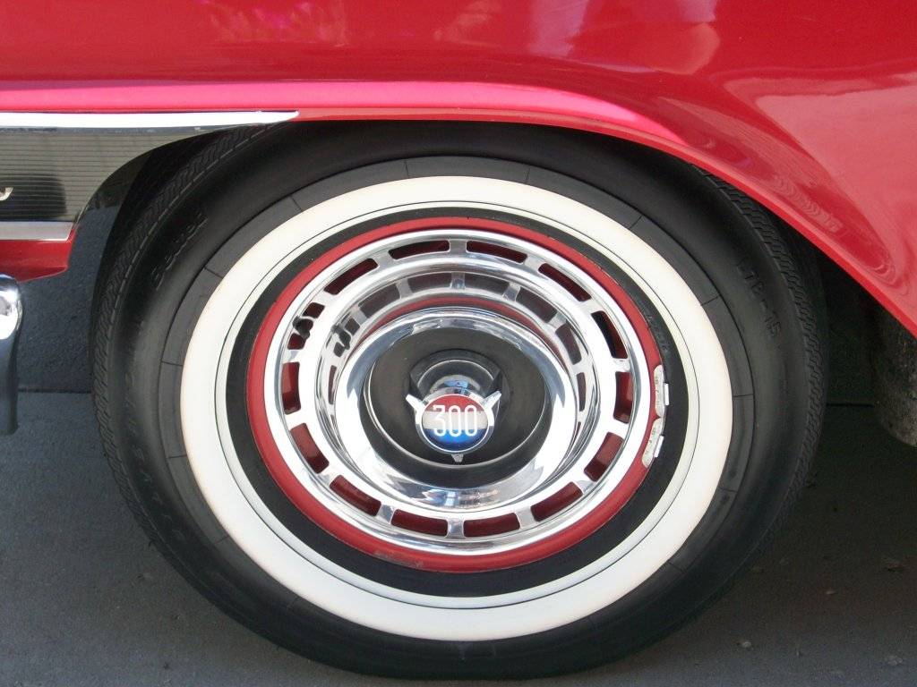

I have several collector cars with both bias and radial tires. I would suggest you chart the advantages and disadvantages to both plus the pricing column. I like my bias-ply from Lucas tires. for my '59 Imperial and '62 Chrysler 300. With your car being 1972 I suspect you can choose either from the standpoint of what was on the car in that year. On my '59 this is the second set of wide whites from Lucas. The first set had no weather cracks they were just 25 years old. The second set is about 8 years old now and the most noticeable difference is not "flat spots" as the car can sit awhile. IMHO radials have more of a tendency to blow out as they get older and bias-ply might peel the tread section off but does not blow out. The price might trump all of the issues mentioned above. A radial in your size would be about $100 plus, white a bias-ply are close to double that price. Of course, if the car is not driven often you could check FB Marketplace and craigslist, try typing size, and the verbiage "whitewall tires". Below is a set I found about four years ago on Craigslist as he bought a collector car with two sets of tires.
