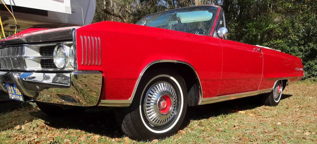

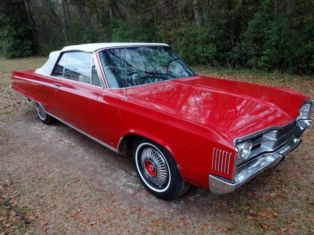

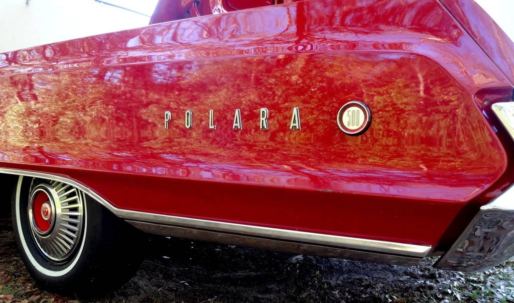

I brought back the original paint on my 67 Polara after 46 years in storage. It was heavily oxidized with many minute scratches and was pretty questionable when I started. I did this myself in the yard.
Here is a link to my thread on the process and products used.
67 Polara 500 convertible

This was a seriously oxidized original paint surface. A wash with dawn, then a scrubbing with comet counter cleaner, another wash with dawn, then 3M chemical compound and 3" buffer pads on a arbor and a battery variable speed drill motor, then a carnuba wax such as J-wax or mothers.
This process is great for an original enamel paint, not as good for a base/clear surface.

Hard to argue with those results... At least we agree on the Dawn!
