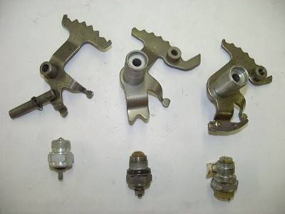

Since a picture is worth a thousand words, and the interwebs is full of them, I found a good pic of the different levers.
55-64 on left, 64-68 in center, 69 and later on right.
It's my understanding that 64 cars w/console use the center switch.

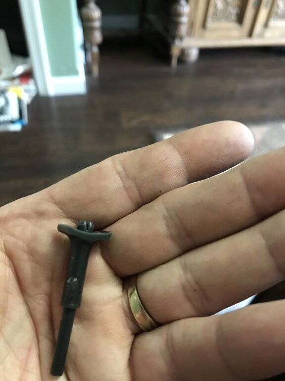

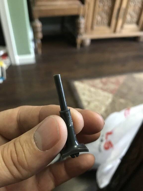

Do you have the part number for the middle operating lever? Mine seems to be missing, the switch works but no lever there to engage the nipple on the switch
For ‘68. Pin, steering column gearshift tube switch w/ auto trans. Column shift
2883211 all Chrysler Plymouth Dodge except imperial.
One would think these would be a dime a dozen.

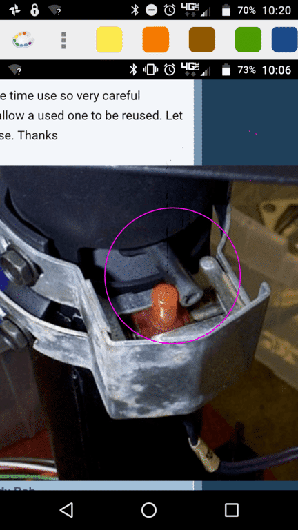

Called operating lever (not to be confused with gearshift indicator operating lever)in Service Manual. One time use. If the column is taken apart this needs to be replaced. I believe it is a different set up in ‘65. I don’t have that manual.
‘68 lever before the pin is pushed in to secure it.

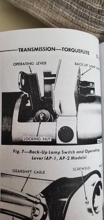

Yeah I have the 65 plymouth manual and i have the AP1 AP2 model on my fury and this is the type of lever it uses
