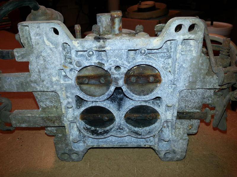

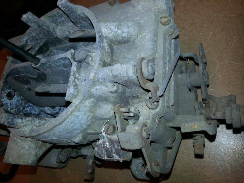

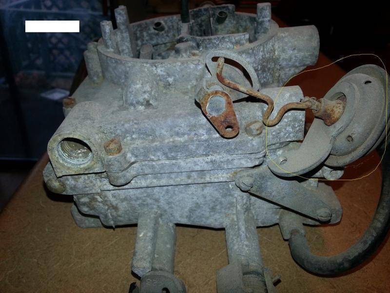

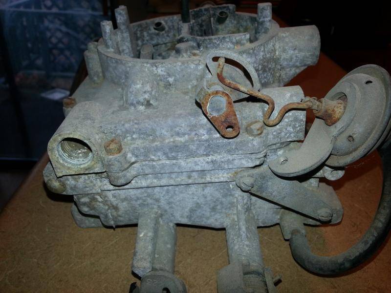

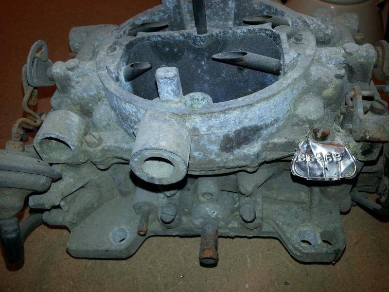

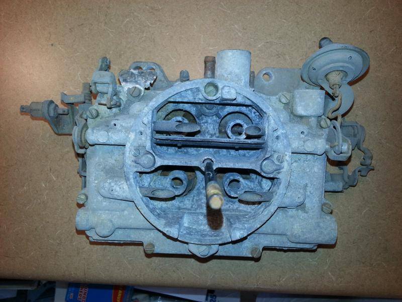

A while back I mentioned that I was told the carb. was to far gone. Some members said almost all carbs can be rebuilt. When we were at the shop yesterday, I decided to bring the carb home. Here are some pics. Is it to far gone from what ya'll can see. If not...what should be my first step?

If it was me, I would spray the heck out of it with penetrating spray, especially around the screws. Do that for a few days and then try and unscrew them. Maybe soak the whole thing in a bucket. I wouldn't buy a kit until you find out if it is usable.
Well that carb is a mess that's for sure, i bet the butterflies are frozen in place too. It is beyond the average garage tinkerer to get this unit again. A professional carb rebuilder would disassemble it and dip the body to remove all corrosion and get those butterfly shafts out, they would probably need sleeving.
Here's the thing, its probably far more expensive to rebuild that carb than to find another one same model in reasonable condition and put a kit through it.
Do the throttle shafts still turn if so there might be hope also a bottle of navel jelly. You can brush it on wait a little while hose it off and see if there is any deep pitting damage. If throttles don't turn gets more difficult as shaft bores may get larger working rust out against aluminum that create vacuum leaks shafts need bushed on and on.

I'm gonna start the soaking project today per Stan's advice. I would have gotten to it earlier but got a stomach bug. I do have a question. Do I need to remove what looks to be like a diaphragm with a hose connected before soaking?
The vacuum diaphragm is prob dried out and needing replacing anyway. You could pull it........... But I don't think you would hurt it anymore by letting it soak.
