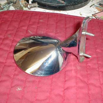

I have 2935338 NOS. fits 1969-70 Fury
Also have 2935337 NOS Left manual mirror 1969-70 Fury 2935806 cast on base
