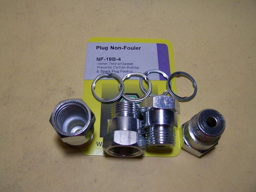

Thanks. What is non-fouler? Is that the hotter plug?
The non-fouler creates a chamber for the spark plug to sit in and operate while shielding it from excessive oil. It can also be used with an O2 sensor. It's really a band-aid to get you through but will work for a while.

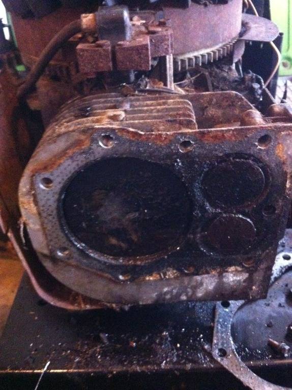

If yours is a single cylinder and looks like this:
Just re-ring it, how hard can it be?
Only if it is a I/C with the iron liner. Which it should be. The older big singles with aluminum cylinder walls just wear too much.
If you buy anything new make sure it has a deck clutch of some sort (usually electric) the flip the lever and allow spring tension to hold belt tight were bad in years gone by, worse now with flimsy brackets and eliminated idler pulleys/tension pulleys in one.
Most of the single cylinder overhead valve engines now are rough running if loaded hard.
