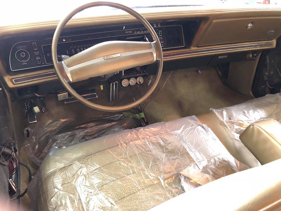

Hi
Anybody know where we can purchase a rim blow switch for that steering wheel? (1972 New Yorker, tilt steering column)
Thanks

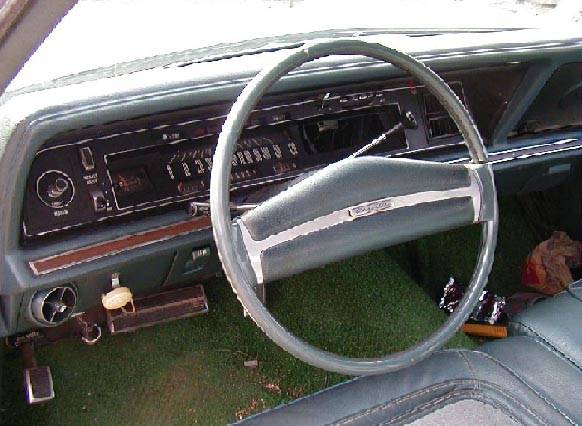

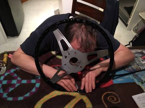

I replaced a few switches for the 3 spoke rimblow wheels that you can find in B and E body cars, (see pic below), so I know what the job is. I know you can buy repop switches for the 3 spoke wheel, but I also know that the switch is different for those 2 spoke wheels. And the switch is RELAY dried out, hard as a rock and I also sent a ground to the relay and the horns sounded, so, the switch is bad. Was just wondering where I can purchase one...
