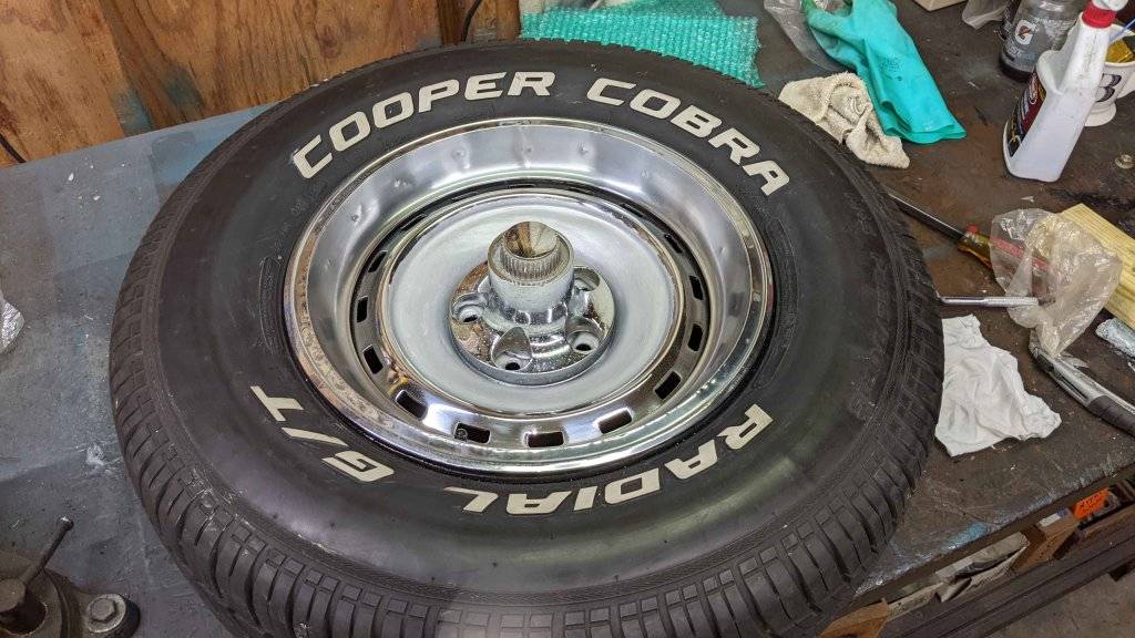

I have bought a set of Road Wheels for my 1970 Plymouth Fury convertible.
I took them and my Cooper tires to a service station to have the tires mounted and balanced.

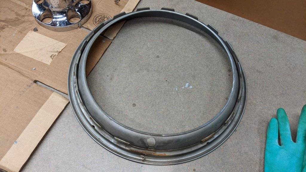

I thought the trim rings would cover up the front balance weights. And I thought there would be room for the weights under the trim rings.
But, the trim rings don't seat all the way against the rims. They bow up particularly high at the tire valve opening. There's only one front wheel weight per rim.
Should I have had him only put balance weights on the rear of the rims?
Or is there some other explanation, like the wrong trim rings?
As always, thanks for your help! Ben
The explanation is the new tire weights are not lead and some of them are thicker Than the old style. Do you have a photo of the weights they put on to see if they are too thick?
Trims rings are right...I have never had issues...413 is likely on to something.

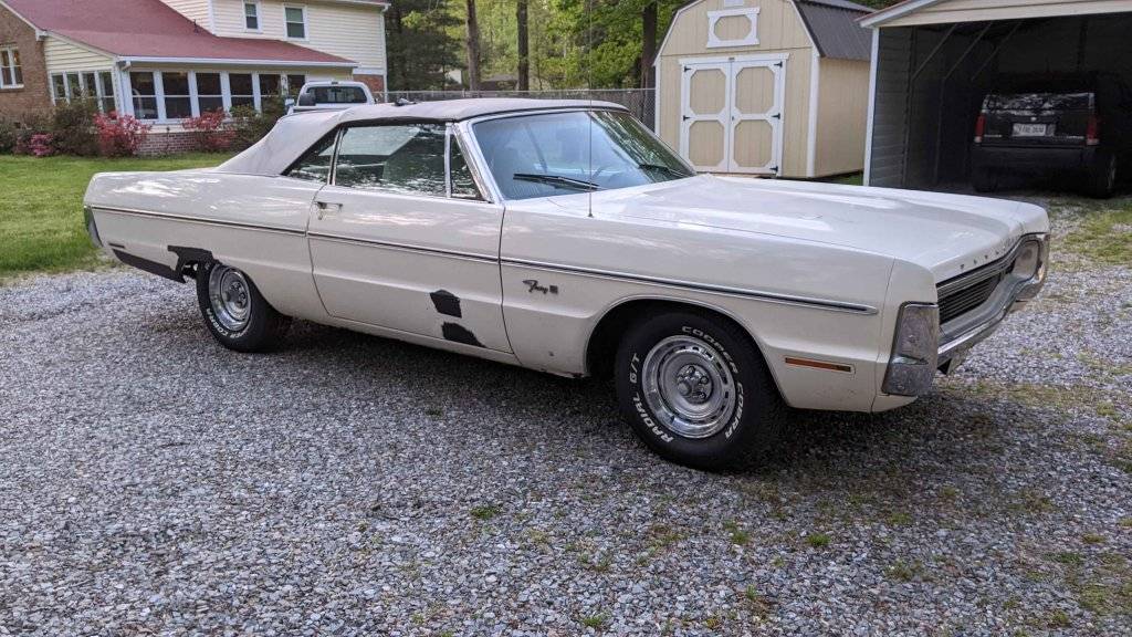

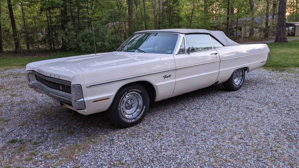

My wheel man was not able to get low profile wheel weights. Balanced using back side of rims only.
1970 Fury has new shoes. Road wheels, first attempt at a resto. First test drive, excellent!
Pics from this evening
