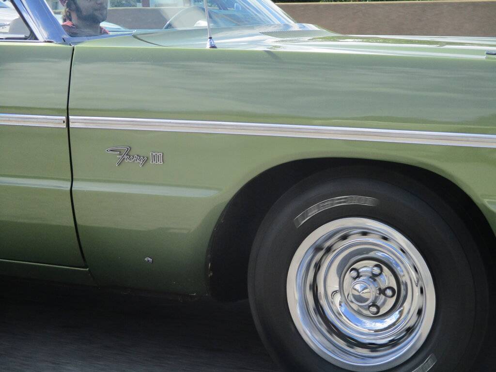

ok, just got a 70 furyIII conv. rim is bent.
i want to replace it. but i found that the 1 i have is all chrome.
all the ones i see have seen have the painted silver or gray section.
not having much luck on info for the all chrome. can someone set me straight please?

Would you have a non moving picture of your wheel , this one is too blurry too know what the rim is made of . We need clear detailed picture of the centre area where the argent paint would be .

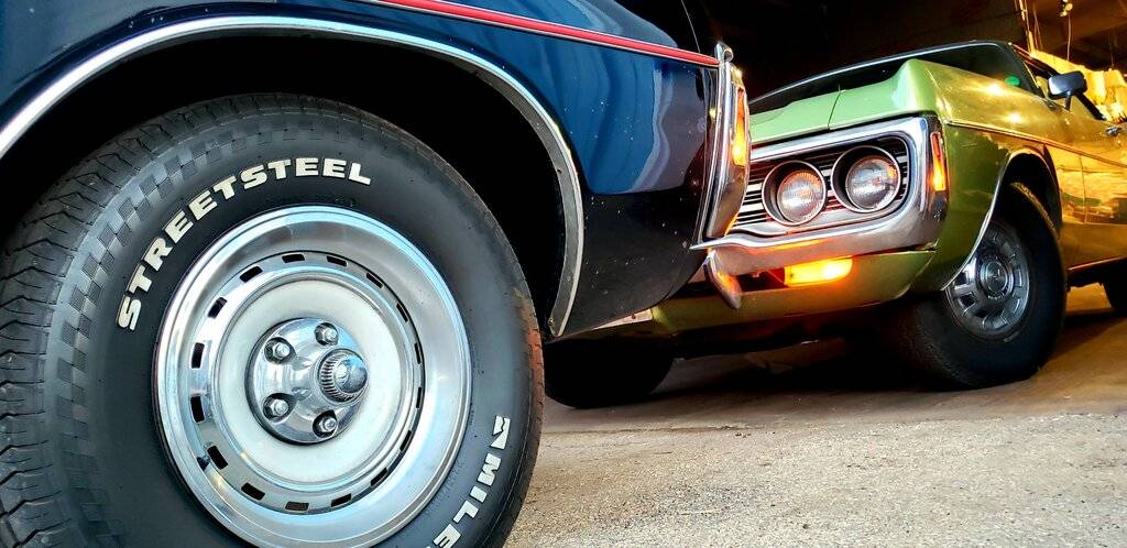

Definitely the 15x7s. Pretty hard to find those at all, let alone in amazing shape like the ones you have.
The centers should be painted Argent if my memory is correct.

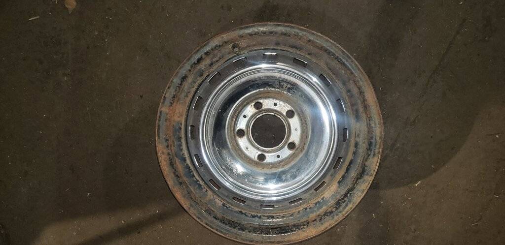

Here is a 15x7 chrome styled roadwheel, you can see the chrome under the worn off Argent/silver center.
no chrome, but i'm wondering if someone sanded the paint off.
can someone set me straight on this?
