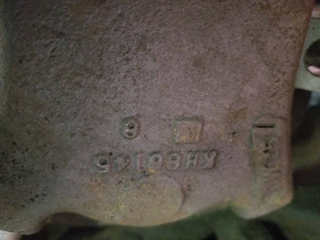

    FWIW, I had the same issue with Summit when I was doing the front disc's. They sent the same calipers that Rock Auto did which were the Raybestos #'s FRC4061 & FRC4062. Like Steve explained, you will not be able to get the pads to fit over the rotor because these caliper's are B Body, and are slightly narrower.
    I had the original calipers rebuilt for under $100, and was done with ordering and returning parts from the online sources mentioned.
    These are the caliper casting numbers on my 71 New Yorker...

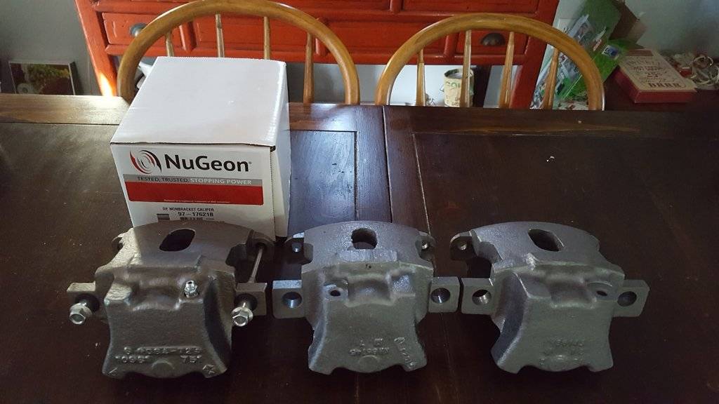

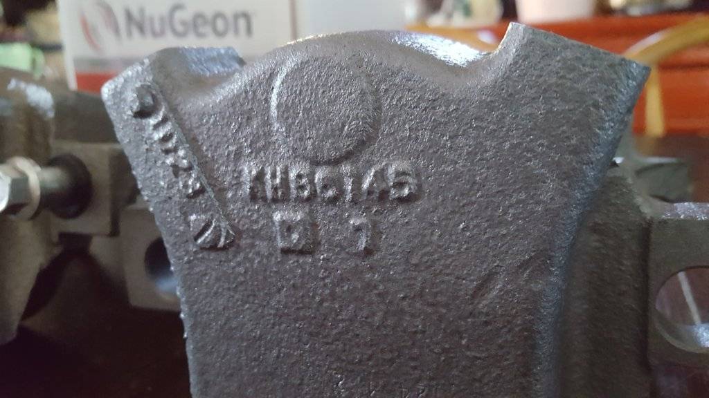

    FYI, Received the Nugeon calipers n are same as original 1973s that I have.Saving those for rebuild.

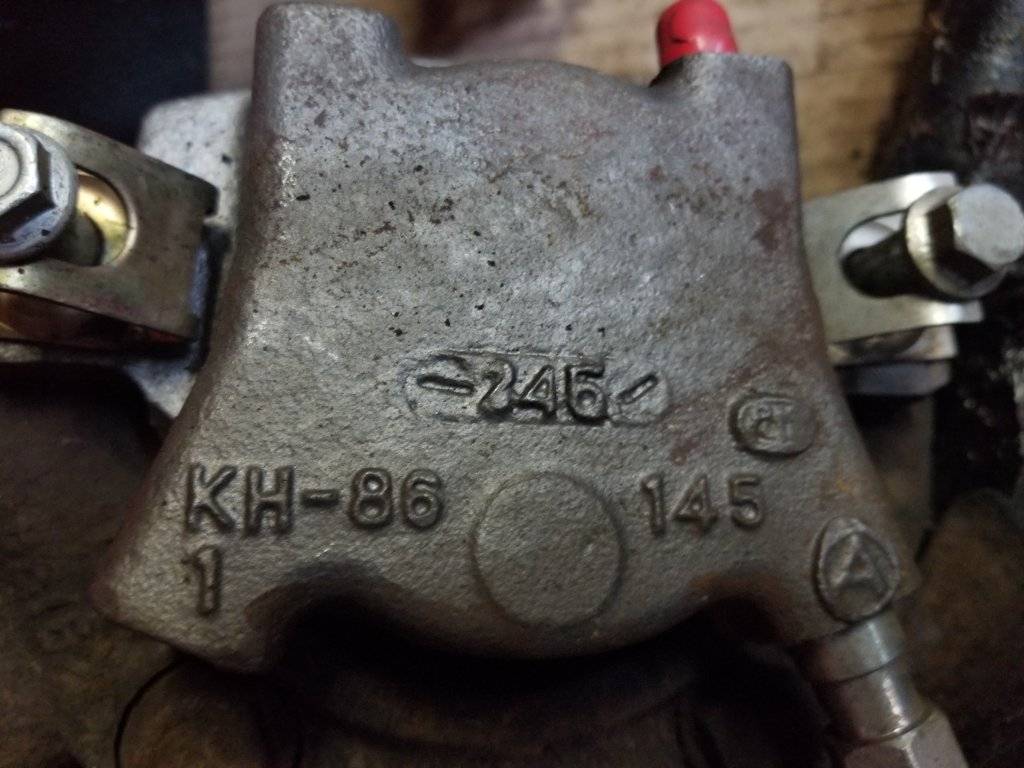

    Ordered what was available [LH side] for a 72 Fury.
    It's sitting next to the originals that I rebuilt with some help from @sixpkrt and @Xenon...thanks again to both of you 20200222_082334.jpg 20200222_082428.jpg
