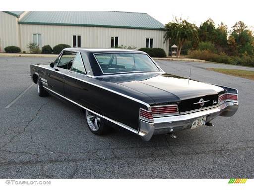

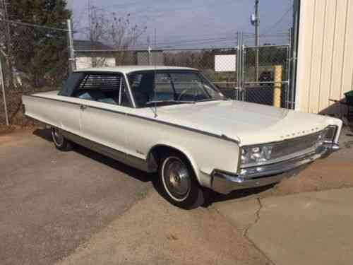

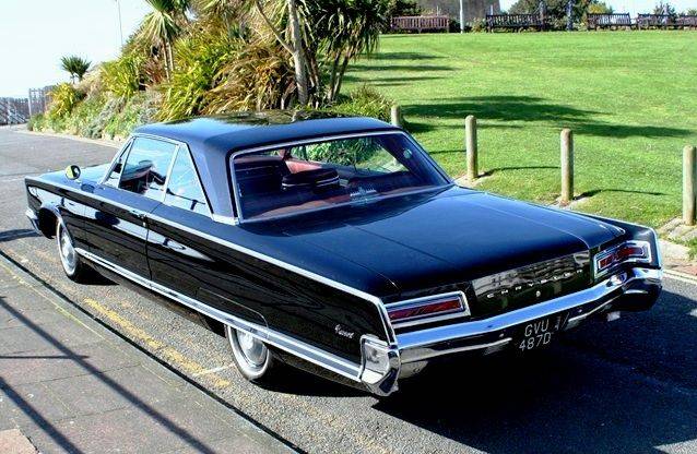

I am restoring a 66 Chrysler 300 2 dr hardtop, and have learned that the roof C pillars and all along the rear window, really need to be replaced / rebuilt. I realize that the rear windows are different between a 66 Newport and a 66 300. Can anyone tell me whether, but for that difference, are the roofs (including c pillars and other essential style and structure characteristics) of a 66 newport, 66 new yorker, and 66 300 the same?

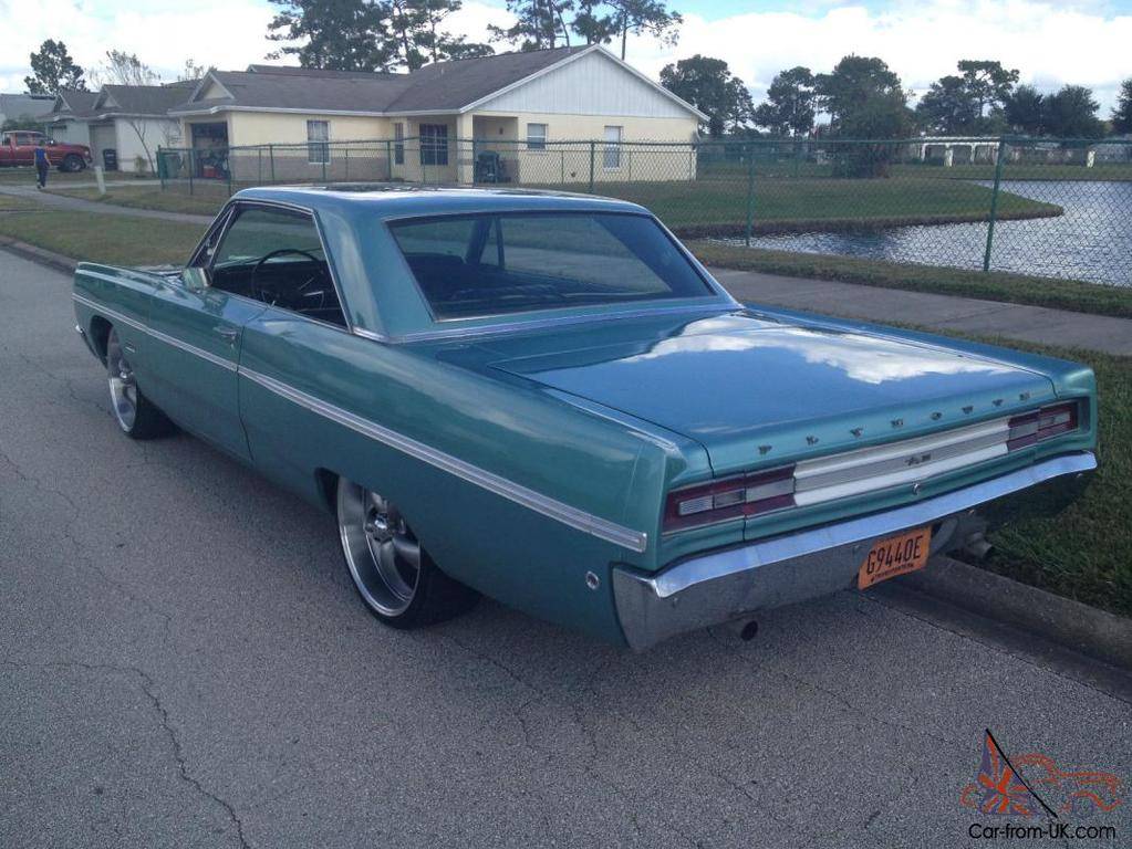

I would think the Newport probably shares that c pillar and window with the Dodge and Fury 2 drs.
Thank you...more possibilities is a good thing...so, I guess I am re-asking the question, but not limiting it to the newport or new yorker, but opening it to all Doge/Chrysler/Plymouth 2 dr hardtops for 1966. I am hoping I can cut the back area of a roof off a donor car, and weld into mine, to save on fab time...but obviously, if the 300 is unique (other than the rear window) then I can't do that. I appreciate all the info you-all can give me. Thx.
All three Chrysler 2 dr models had different rooflines and C pillars.
I would look for a rear window glass cross-reference chart online.
