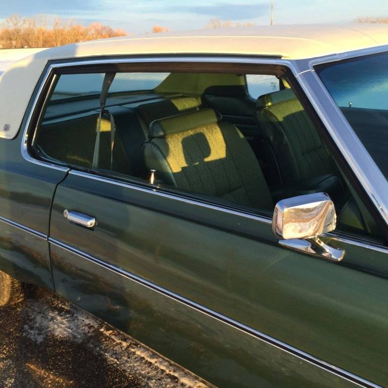

PClancy, if you or a fellow member has a picture of the profile, could you post a picture of it. The AS1720 or 1799 is more for the glass channel runs and not a roof rail seal.

It's the thick bank of weather stripping that runs just under the roof line and helps form a seal when the window is rolled up. Is that what you meant by profile? Please see attached photo and many thanks!
The issue is that the correct profile may be available in a bulk extrusion, but for the most part, all of the roof rail seals consist of three pieces which will be different profiles. The leading edge that is a finished end up near the cowl and A-pillar will be finished end, then you will have the bulk material that the glass rolls up into for the door and quarter glass. For some cars, they will have what I call a tail which is the third extrusion that wraps up into the end of the quarter glass area. Sometimes, we can take and cut a used original seal up and splice in the A-Pillar end and quarter end onto the bulk extrusion to resolve the issue. Hopefully, you will be able to understand my abbreviated description.
If more questions, you can drop me a message or post a question.
