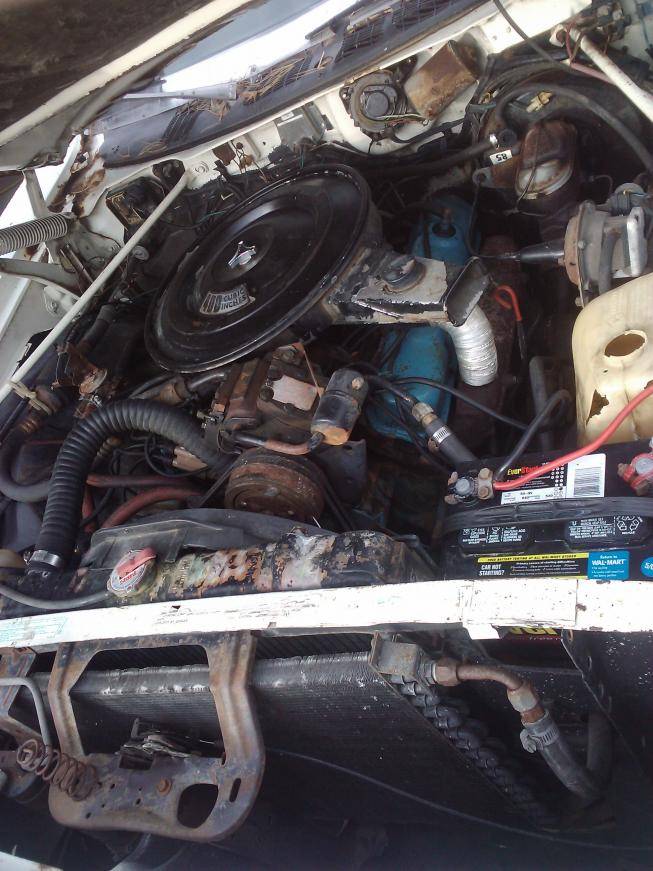

    A peek under the hood (the wiper fluid reservoir is a goner, but the rest is still great!)

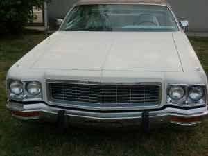

    A tiny pic from the front

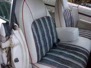

    A tiny pic of the (nearly perfect) interior:
