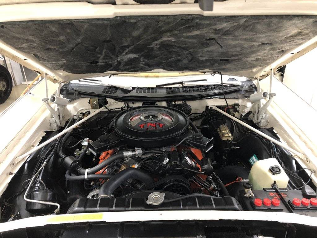

******************** UPDATE ********************
I got the wagon back today the radiator shop had the car for a week. they removed the radiator and boiled it for 2 days. Then they removed the tanks and rodded out all the loose junk then resoidered the tanks back on pressure tested it then repainted it. Pulled the thermostat ( which was in pieces) then replaced it with a heavy duty 160 degree one also replaced the housing which previously had been overtightened and was crushed impeding the waterflow.
Completely flushed the engine and heater core.Installed the radiator with new hoses & cap. Filled with new anti freeze. I drove it for about 1/2 hour never got above 160 degrees. So happy with it now hopefully no more driving with constantly looking at the temperature gauge.
Trace 300 Hurst
Professional Tinkerer
May 27, 2018
1,901
2,267
Ponte Vedra Beach, FL
I got the wagon back today the radiator shop had the car for a week. So happy with it now hopefully no more driving with constantly looking at the temperature gauge.
Good report! Hopefully, your example of doing the right thing by fully attacking the overheating problems of a 50+ year old car will inspire others to do the same thing instead of cheaping-out with stopgap measures.
I did the same thing with my overheating car last year by replacing and/or flushing EVERYTHING. New rad and quality repro cap, hoses, 'stat and housing, flushing block with the water pump off (so messy, so much crud came out!), and flushing the heater core. Now I run at 180* all the time, AC on, in miserable Florida temps. Like you, I'm "so happy". :thumbsup:
But I still look at that damn temp gage too often. :rofl:
