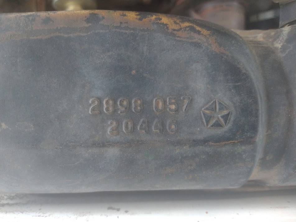

By now many of you have seen Gertrude, the 1968 convertible Newport that Chrysler apparently hastily cobbled together for export. Given how she came with a VERY OLD 115VAC plug-in coolant heater pump, I suspect this car saw duty at those latitudes above 45 degrees North. The following radiator came on the car:
This radiator lists as follows: 2898057 1968 C 22 383 MANL HTR
That's consistent with other quirks of this car; the starter relay meant for a manual transmission and the transmission cooler bolted in front of the radiator as an afterthought. Be that as it was, the hoses and clear age of the rust on the bolts all tell that these parts went off the assembly line as they now are.

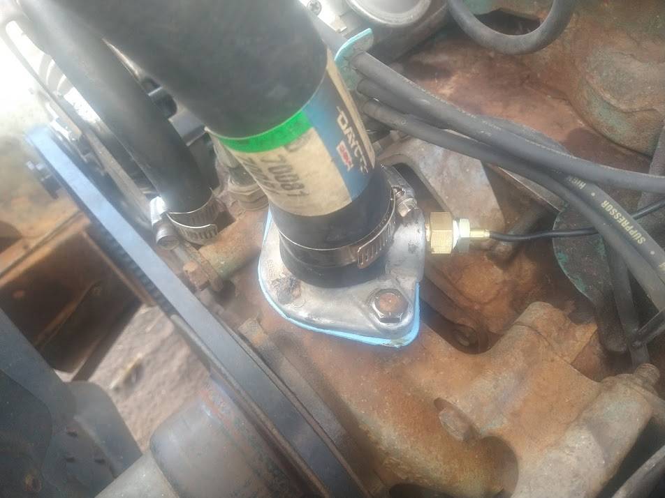

The water pump housing doesn't permit any extra temperature gauges, so I got clever and bored out a Dorman thermostat housing of this sort:
Its VERY EASY to drill and tap for 3/8 inch NPT into the flat spot facing diagonally out. I did so.
The capillary probe doesn't block or interfere with the thermostat. I made SURE of that before tightening down, taking some pains to rotate the thermostat to assure that it opens on the side opposite where the probe enters the housing. Admittedly, until the stat opens, the temperature reading from this arrangement might lag a LITTLE behind what the block coolant temperature is, but it doesn't lag much. This engine warms up to 180 F in under 5 minutes at fast idle.

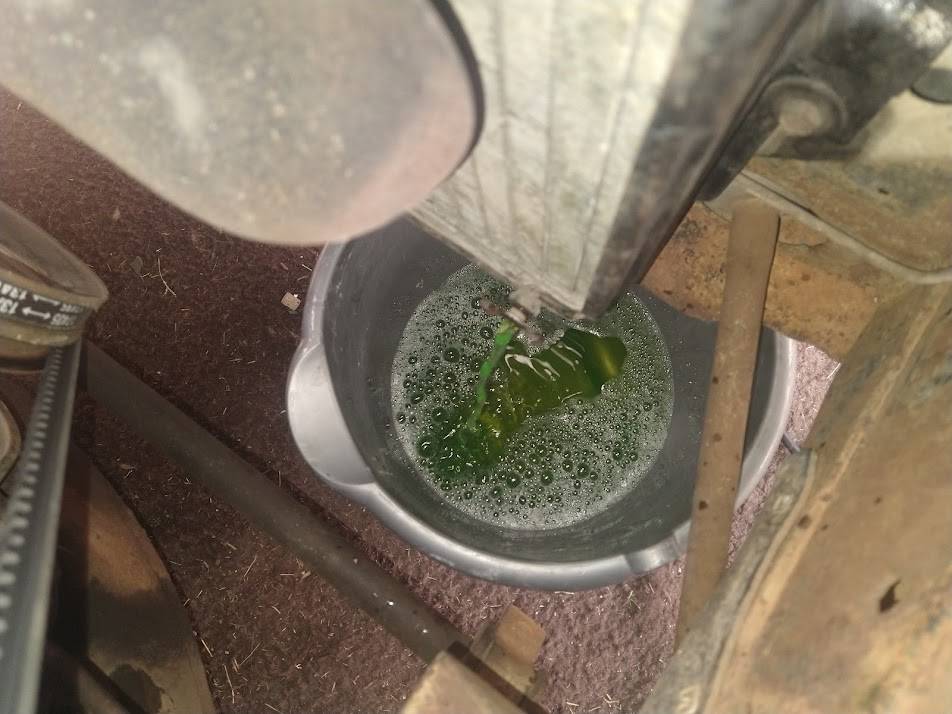

Thanks Matt! I changed that molded junk out with a good Gates Green Stripe hose, which has a good stiff coil spring from end to end. I had a learning experience with molded hoses w Mathilda this past Spring. For the night, I'll see what happens with the new hose and no thermostat. BTW, the coolant was CLEAR and CLEAN, indicating my flush job from the preceding week got all the loose **** out anyway.
See the bottom of the bucket? No rust or particulate debris in this coolant!
