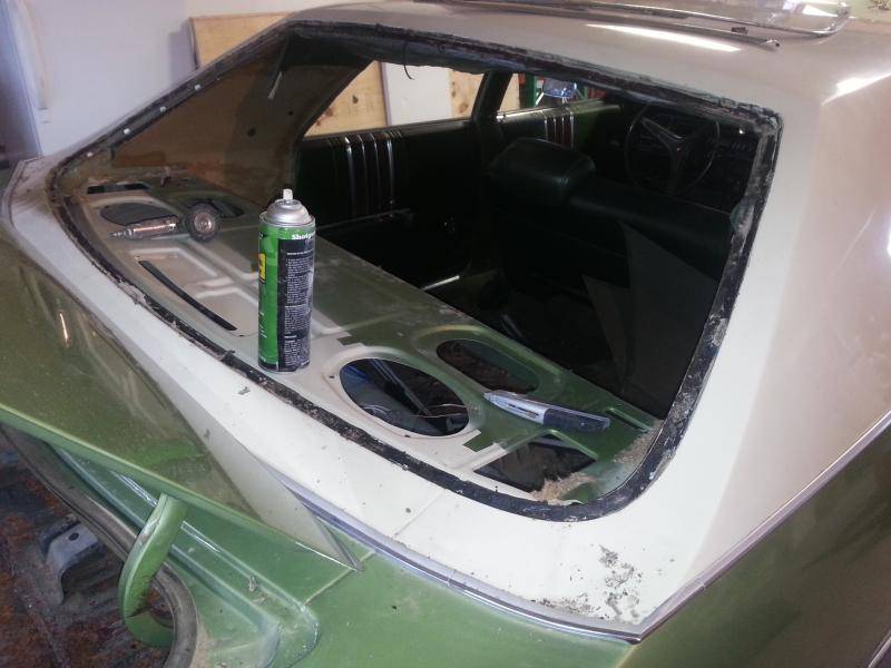

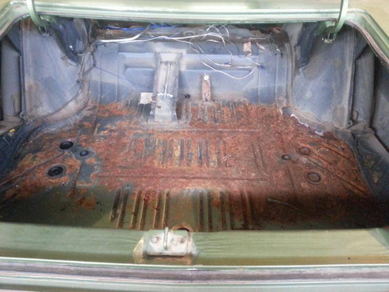

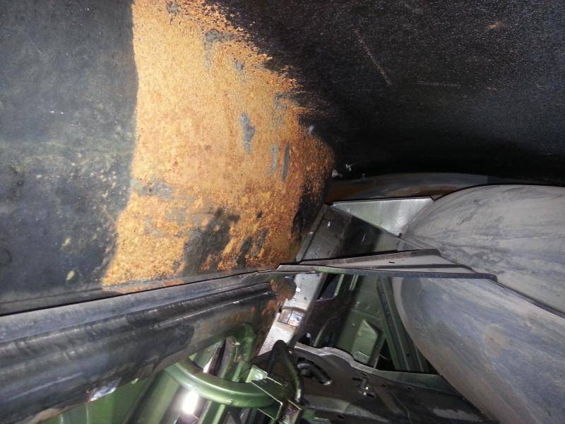

after buying the car last spring i decided to pull the mat out of the trunk later that summer to find this. the back window leaks :soapbox: so after it sitting at a body shop for 4 months and them not touching it i decided to give it a shot biggest pain was getting the back window out i order some rust bullet to spray to trunk with when i clean it out and the window track the roof i will have a different body shop paint has anyone sprayed rust bullet before im hoping my spray gun can handle it
I have sprayed Rust Bullet specifically. It needs one part reducer to 4 - 6 parts paint. You also want a large tip nozzle used for primer paints. It will come out beautiful with two coats.

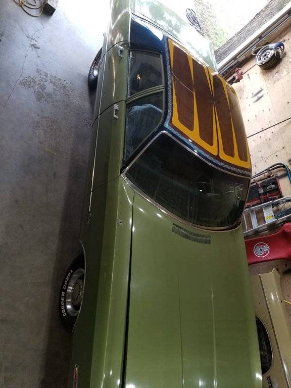

Many years later. Now it needs a motorView attachment 180720
love that roof
It's not my style... but who cares what I think... it's not mine. I appreciate the effort and I do love that she's getting the love she deserves.

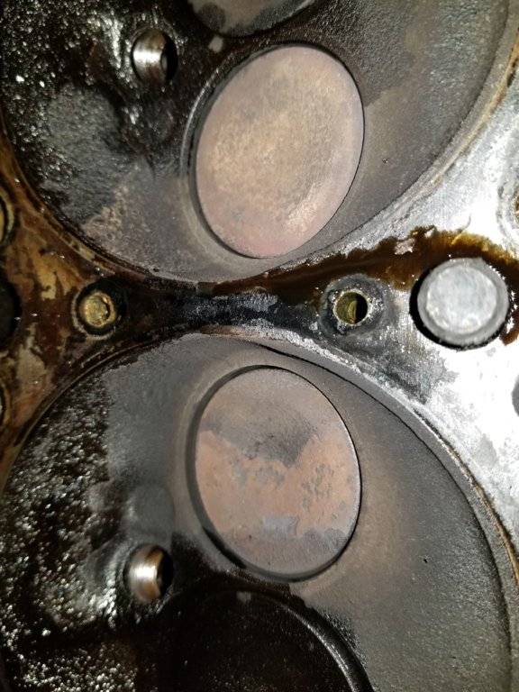

Also, as to the "needs a motor"... what specifically has gone wrong? You might not need a full blown rebuild... depending on what's wrong. Compression and leak down tests would be a great place to start... I can appreciate the desire to make it all fresh, but in reality, lots of engines get rebuilt when they still could have been repaired.

Mainly its the heads values seats are shot there are sunk in about 1/16 car has 101000 miles
