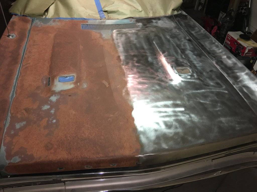

I've gotta say, while I've used them before, I'm super impressed with the 3M Bristle Disc (green one) when it comes to handling rust. It eats it right up.
Now if I only didn't wast about 4 hours today with the front valance, bumper, fender extensions..., I'd have gotten a lot further with rust removal.

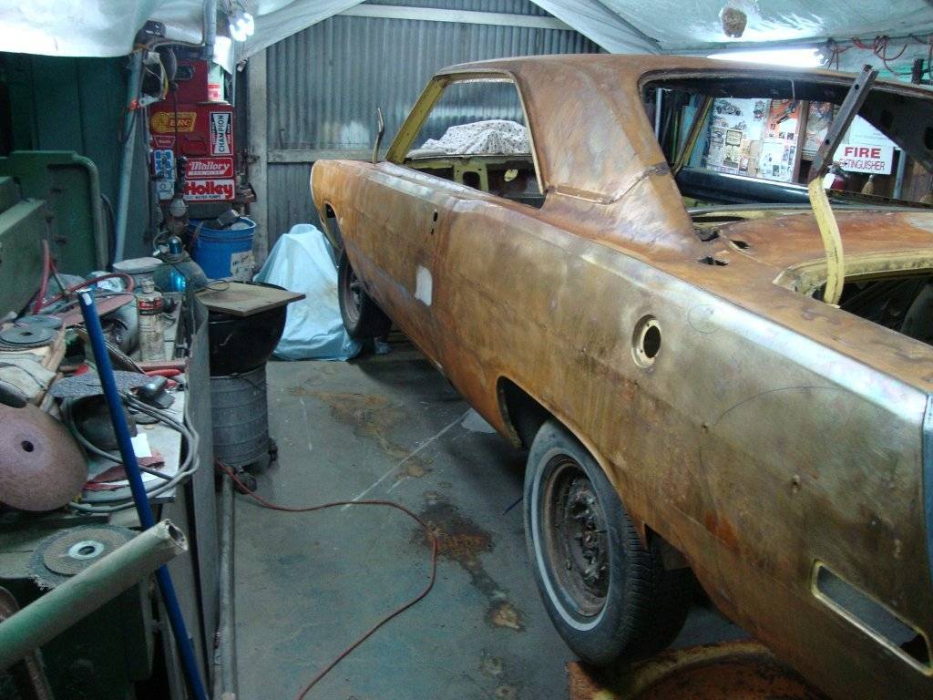

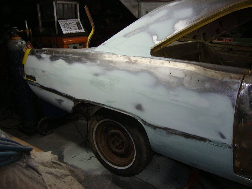

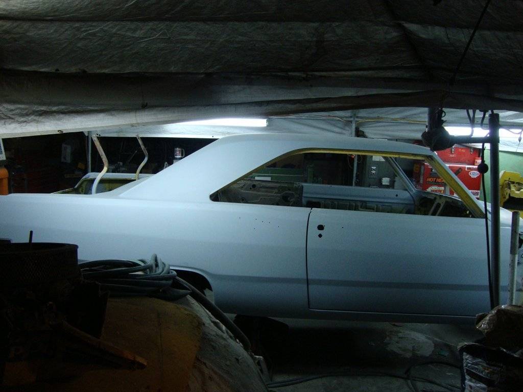

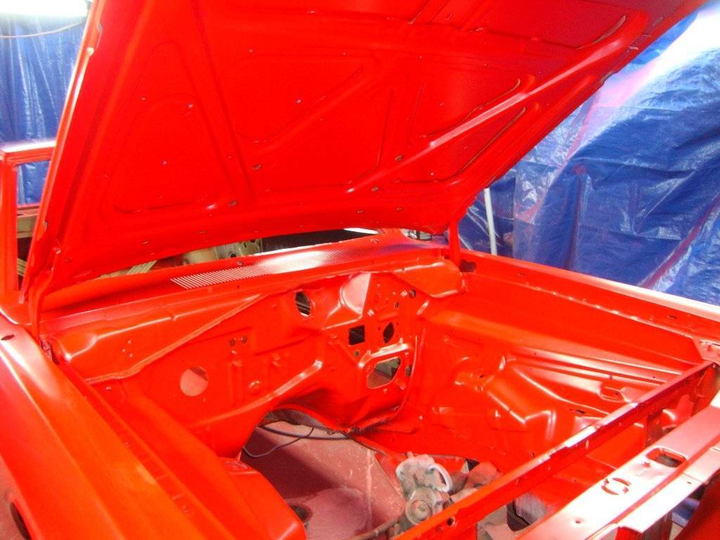

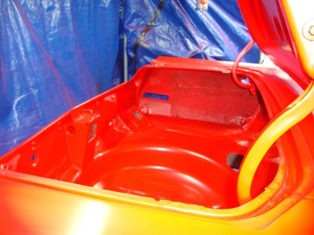

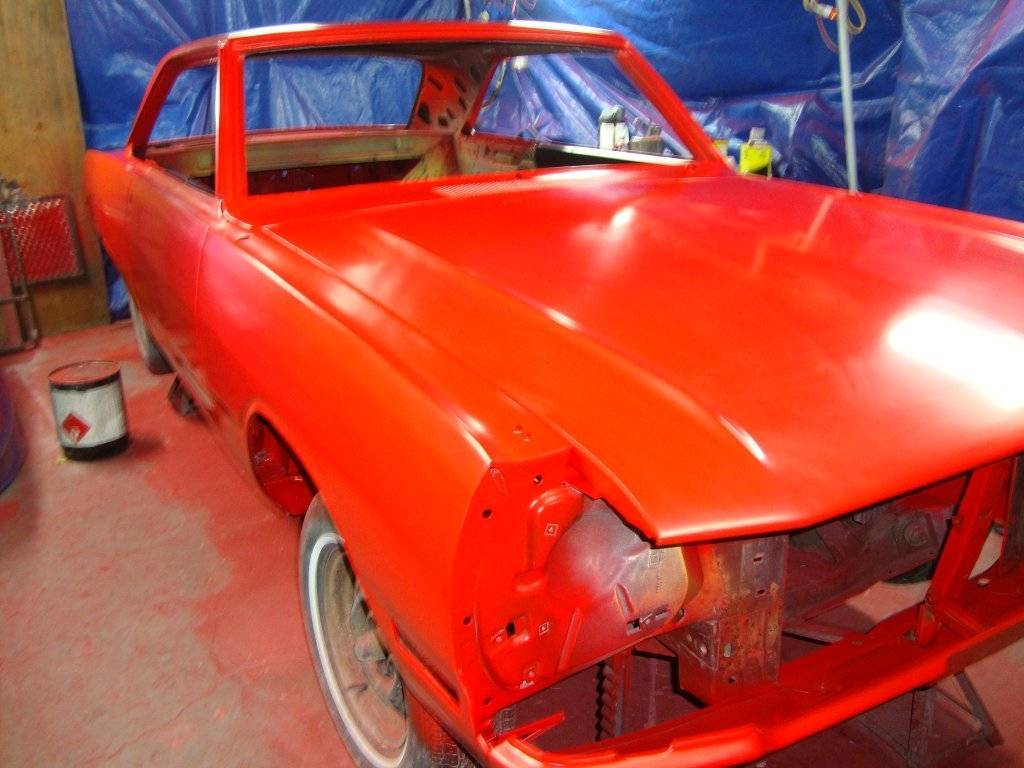

still must kill the rust in the metal pours , need an acid . i've used a watered down vinegar solution . just a spray bottle , wet the whole bare metal surface . it kind-a turns orange rusty color . let that dry . then back to a scuff pad and bare metal ready for primer sealer . if you don't kill it . well it will come back as bubbles under the paint job . and then its back to bare metal again . todays paint jobs are not cheap at all . so all your prep will save you money . pics of a dart i did , with 2k worth of paint on it after this .
