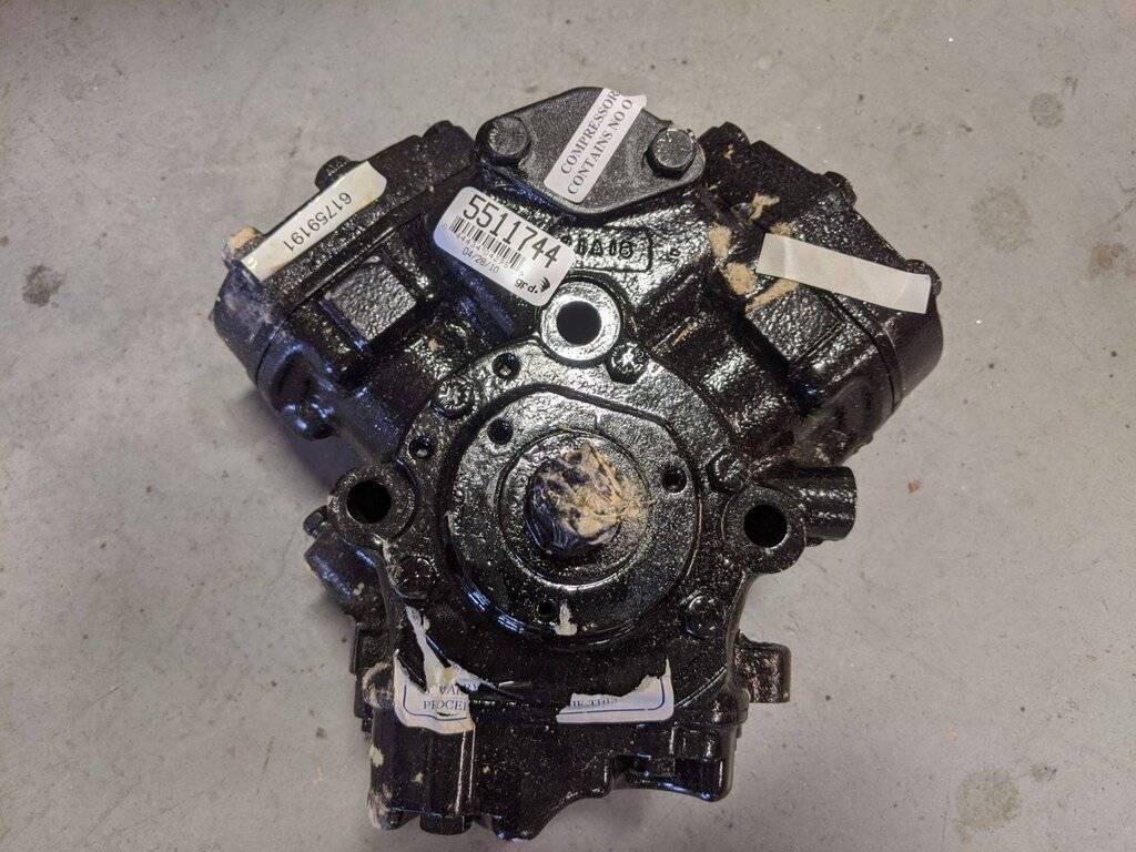

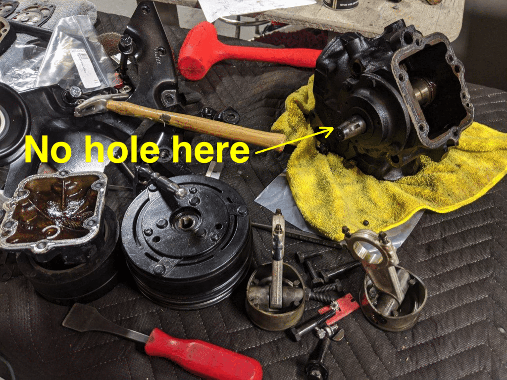

I'm working on a 1974 440 car and am restoring the AC system.
I order a new/remanufactured RV2 compressor for a 74 440. I also head down the path of rebuilding the "what I think is original" RV2 compressor off the car.
New compressor arrives; it has three mounting holes.
The "original" compressor has two mounting holes.
(See pics)
Does anyone know the differences - or the "why"s of two holes versus three holes?
Big block small block - were the AC pumps different?
Thanks in advance for any help, guidance or info!
Ron

The number of mount holes will not make any difference as to the functionality of the compressor. Some of the compressors had the 3 mount holes others had two. I think the two mount hole style is a later compressor. The unit on your work bench is an early style because it still has the oil pressure relief system, the later ones did not.
Dave
The number of mount holes will not make any difference as to the functionality of the compressor. Some of the compressors had the 3 mount holes others had two. I think the three mount hole style is a later compressor. The unit on your work bench is an early style because it still has the oil pressure relief system, the later ones did not.
Dave
Thank you Davea for your input! I appreciate your comments!
@Davea Lux - while you're usually spot on and I rely on your expertise therefore, this time you're backwards on the mounting holes... but completely correct in that it will make no difference in the functionality. :poke: :)
3 hole compressors were early style, 2 hole were later. I went through this a few years ago.
My 66s have 3 hole compressors and corresponding mounting bracketry.
A 3 hole will mount up fine in place of an original 2 holer but a 2 holer will cause one to have brackets and braces that are not useable when used in place of an original 3 holer. Unwanted vibration may result. Also, @Wile E Coyote the 3 holers are rarer now, and someone may wish to have it. See if you can get a 2 holer for yours and sell the 3 holer to someone needing an earlier one.
After 50 years, I do not always remember them all! Fixed the original post.
Dave

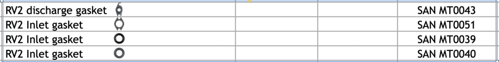

Compressor gasket set (oem style gaskets), and shaft seal kits are available from Classic Industries.
MD646747 - 1961-76 Mopar Rv2 AC Compressor Shaft Seals
MD646748 - 1961-76 Mopar Rv2 AC Compressor Gasket Set
Front shaft bearing (early RV2, up to 1977) -Mopar #
2019 681- available on eBay.
NOS MOPAR 1966-1974 RV-2 A/C COMPRESSOR CRANKSHAFT BEARING | eBay
OEM style (metal) inlet/outlet compressor gaskets are available from Santech
