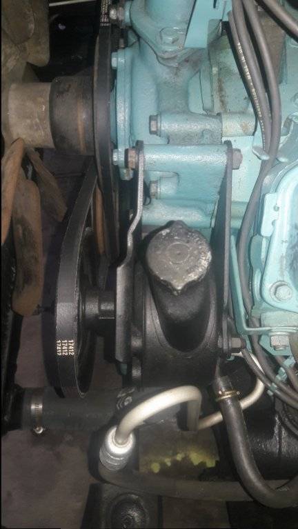

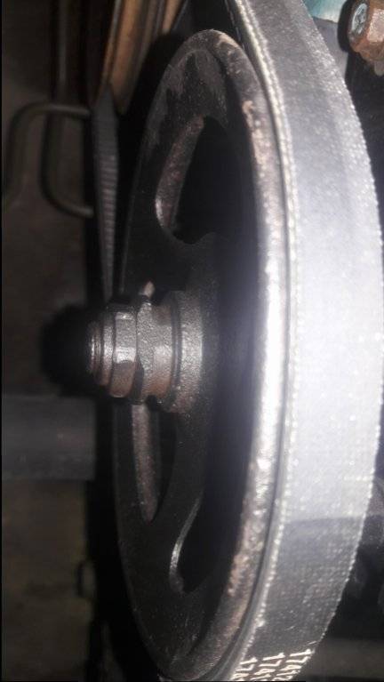

I did this also to my 300. The steering feels so much better. It is to later tonight, but I can post some pictures tomorrow. Also another option for the brackets would be Murray Park.
As promised here are pictures of a Saginaw pump on my 300.

Oh cool, thank you sir. I'm still waiting on a bracket. I should've just ordered everything from Bouchillon's, but I decided to go the cheaper route and piece it all together. I think I finally have the right bracket on the way and everything I need.........knock on wood
