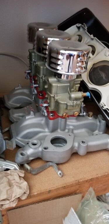

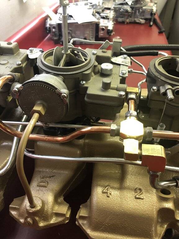

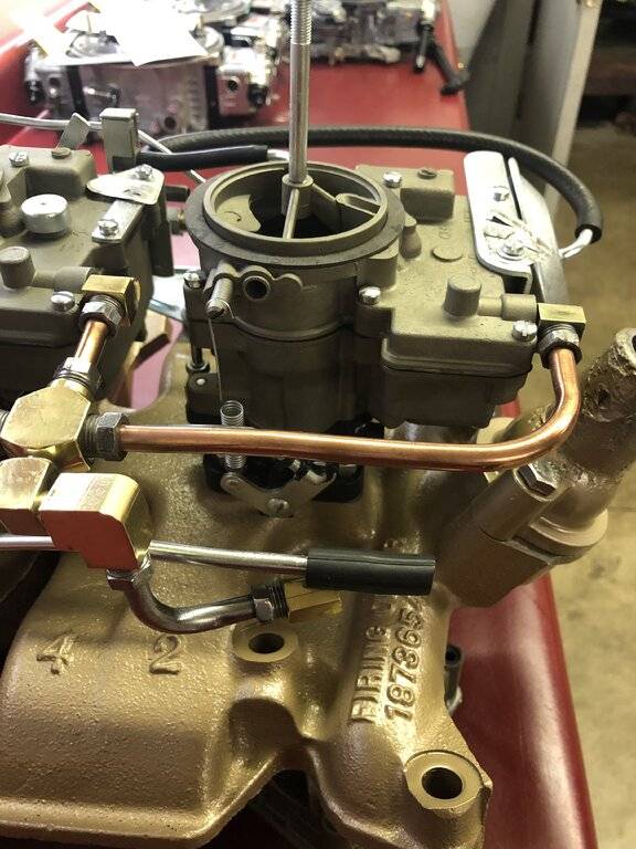

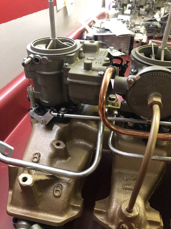

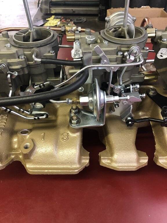

    9F3AEFBA-D004-419F-9F63-CB1F2706085A.jpeg FD83EAE8-C8CD-4C0E-9DE0-D7C2F7B27709.jpeg 68C96FC1-7119-4B29-86AC-7395ED0ED227.jpeg F8F65E5F-FA4B-459E-A4B2-C7B6DCEFBC12.jpeg 30F17396-6633-432A-A04C-C8864BE08835.jpeg 8907B69C-A02A-4A7C-A40A-E7AEF3ECEB6C.jpeg 26DF1B1E-0EC2-4315-86D3-31A330139000.jpeg 46007250-C8CD-433F-81A2-C8D6BBB53BA6.jpeg 83C56167-00D3-478C-AC4A-E96ED40414B2.jpeg 57 olds J2. This thing was 19k mike, all original.

    So how does one test run or set up these carbs without the engine? I am assuming that they are somewhat sequential. No need for trade secrets, just overly curious.

    They get test run individually to make sure that they are doing their jobs. The outboards have different jobs to do. And making sure that the fuel is where it is supposed to be, when it is supposed to be there. Really not much voodoo involved. None of them carbs know that they are on a tripower. The linkage is pretty much unadjustable in stock form. And the customer knows if there is any problems, he can bring it to me.

    The centre carb has a tube running from an assembly (sorta looks like a vacuum unit?) to the centre runner on the intake, held in by or the aperture controlled by a small flathead screw. It looks like it got painted Olds Gold as a fixed part of the intake.
    What is this and its function? As I look at it further, must be a bimetallic choke and heat tube... yes?

    Very cool, are the vacuum pots original, or?

    Yes sir, heat tube for the choke

    Yes,restored
